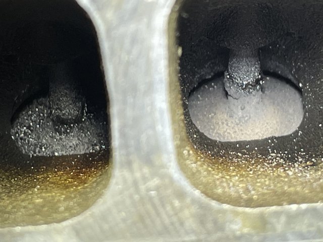

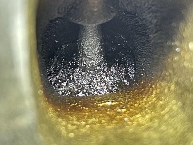

They were pretty nasty looking after 130k+ miles of my typical spirited driving (including several track days and many more fun days driving to ski resorts on snowy mountain roads).
They all had build-up, but some of them less so than others.

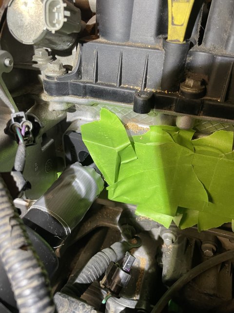

  • I used a lot of frog tape to cover up ports I wasn't blasting. I also used it to cover up any other holes (vacuum lines, bolt holes, etc).

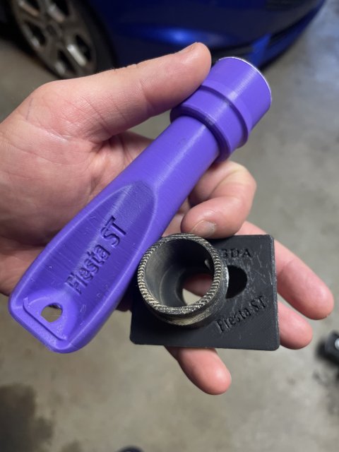

  • I used a custom-made adapter similar to the one linked on page 2 of that same thread: https://www.ebay.com/itm/Ford-Focus...-Cleaner-Walnut-Blasting-Adapter/113708286072
A note on that adapter: I shot the seller a message asking if he could make one for the 1.6L EcoBoost. He was happy to design and manufacture it for me. I just needed to send him a few photos and measurements of the valve ports, and within a week I had from him two adapters to try. They had slightly different designs, and ultimately I used the black one. (So if you're reading this and looking for an adapter that he doesn't make, even if it's not for a Fiesta, shoot him a message!)

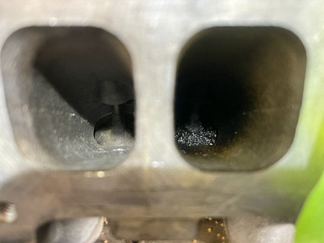

Each valve got repeated walnut blasting followed by blowing out the walnut with compressed air with the shop vac running the whole time, until I was satisfied with the results.
Here is a side-by-side of before and after I cleaned the first two valves.
