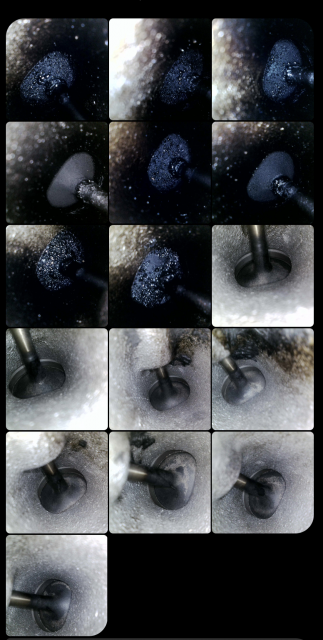

I don't have any personal experience with this, however from what I have read, walnut blasting would for sure be the route I take.
I had it done locally for $450 when my car went under for some major work last year. It really helped unlock a bit of peformance and improved gas mileage for sure
