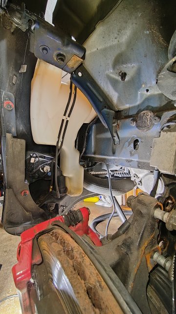

The washer fluid reservoir is tucked inbetween two solid points. One is the frame that supports the bumper on the driver side. Based on your description there's a chance there will be some deformation to the frame that supports the front-end. Doesn't take much. Your standard auto repair won't want to mess with anything that has damage on that frame rail. Some vehicles there's a short section of frame that bolts on/off but the example I've seen, there was still deformation to the permanent section that doesn't bolt on/off. A welder that works well outside the normal boundaries and restores vehicles, may entertain the idea of cutting off an undamaged section of frame from a junkyard donor and reattaching to your vehicle.

Darn, I remembered that bottle to be more out in the open than it actually is :cautious: But seems like the actual frame is much higher up (blue beam). What's the black curve-y bit, just the bumper plastic? The transmission looks like its on the same level as the bottle, however...

I thought I ran out of windshield fluid like 4 months ago. I don't really use it so I didn't bother replacing it. Well, i went to refill it yesterday and the fluid just poured out. Based on how quickly it flows out of the res I'm assuming it's cracked pretty good. I figured I'd try JB-ing it before ordering a new one or finding one in a yard. There are weirdly very few fiestas in the yards around here. I guess recycling is working.
Is it seriously this much work to service this reservoir? What a lame design. I don't wanna remove that liner, lol. I know I'm gonna break some of those plastic clips that have 150k on them.
