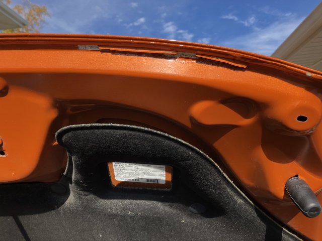

Just was Dinging around today....removed my Turbo blanket. Found this near hinges on back hatch....Thanks ford....you Fucks.
That was a common spot for me too. Also the area around the bolts that hold our wing to the hatch has been a problem for me. Honestly anywhere that metal meets metal has been an issue [emoji23]
