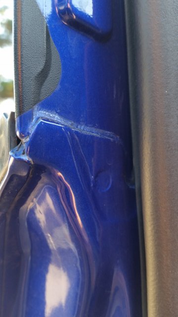

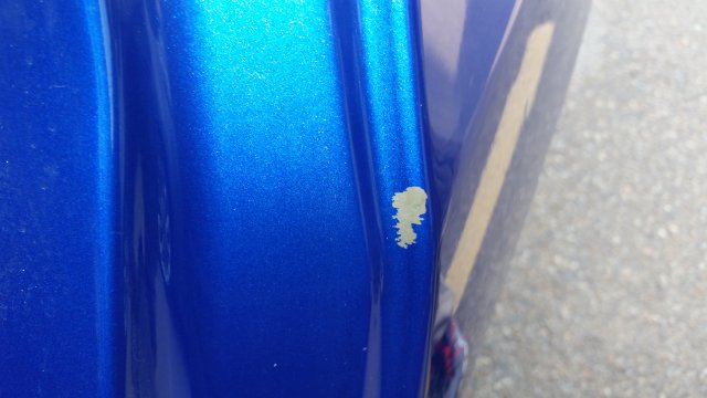

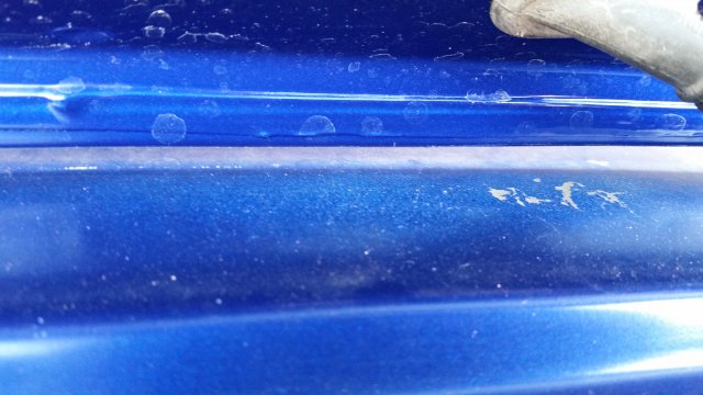

Here's pics of my imperfections. Not nearly as bad as some others but might as well get it early before any real damage is done.

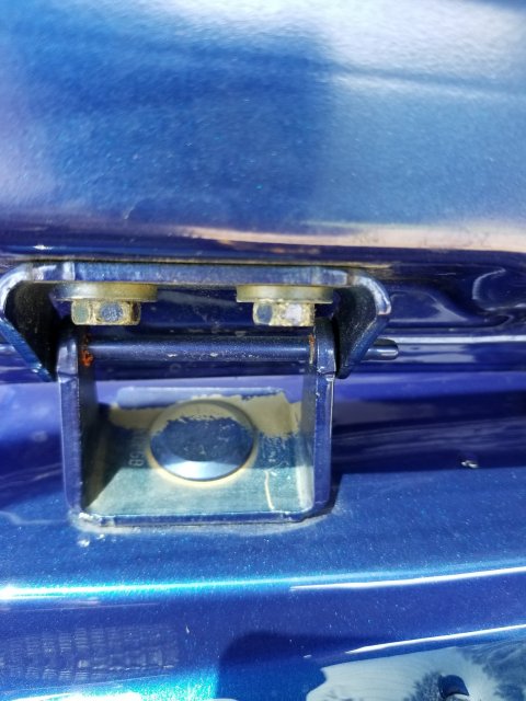

But my hatch is bubbled same as the rest of you
It really makes me mad and disappointed. We just sold our 17 RS due to quality issues now this . Ford really let me down. Wife just brought home a Veloster N. Not sure what I’m going to do

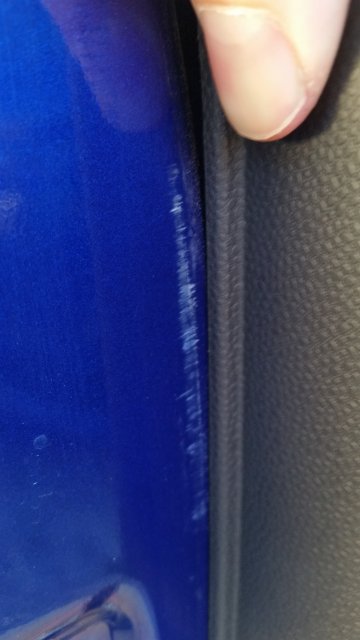

Glad you are getting your paint issues taken care of!

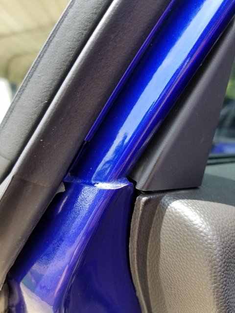

I have this paint lifting issue near the edges too on my 2015. I bought my st used from a Dodge dealership. Does anyone know how I should go about getting warranty work done since I didn't buy it from a Ford dealer?
Not happen I'm afraid to say.... I was at 37k When I found Mine on the liftgate on my 2015. ford dealer told me to Beat Feet. So I decided to give my money on my next purchase to another manufacturer as this left a Sour taste in my mouth. ford....Notice I don't really give them the proper capitalization when I mention them as they are not worthy. Other than that Great car though .... but piss poor paint and quality control.

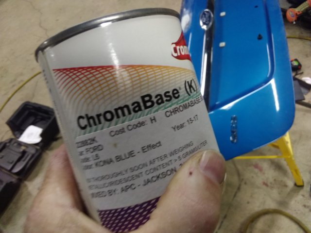

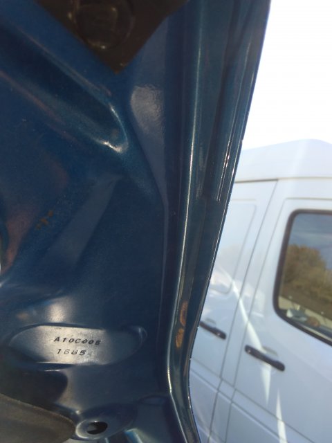

Similar situation on my Kona blue 16. I'm trying to find a rustproofing compound I saw about five years ago. It's a kit that would allow me to pull the interior doors panels and apply it with the provided wand into the door seams. The issue is definitely a primer process failure. Probably during the cleaning process before the body shell was dipped into the Electro coat bath. Something like that. My 2011 Fiesta has no paint bubbling issues. So, something changed.
I'm going to do a rustproofing application and then paint repair as a winter project.
If others are interested in more information about how I am going to proceed with this they can speak up. It will be rather involved and include the prep and paint. I already have the Kona basecoat to paint the new vented hood panel.So, this will happen in parallel with that project.
It's going to be a busy winter.

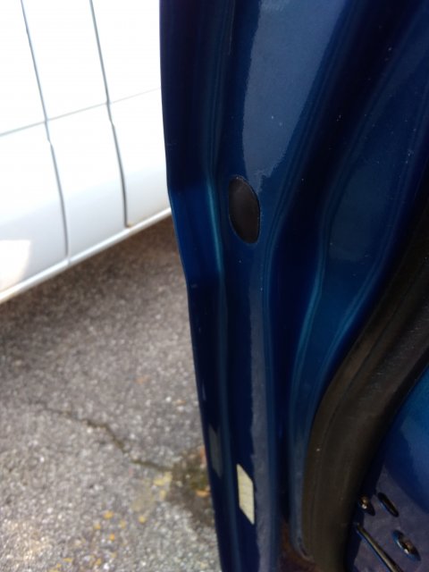

I think it's because they don't apply seam sealer all the way around as there are sections of the seams that are left exposed. I think grinding away the old seam sealer, rust, paint, down to bare metal, then prime, seam sealer all the way around, then just respray the inners will work.

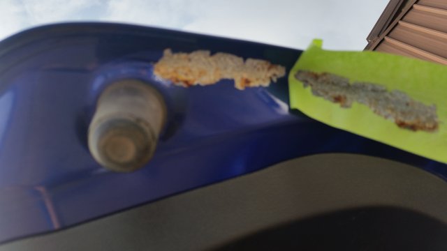

The bodyshop manager came out to talk to me and said that what I wanted may turn out to big a more of a pain then I want.
He was really understanding and knew I was anal about my car so he wanted to talk to me before any repairs so that I wouldn't be unsatisfied with the work. He pretty much said "be careful what you wish for." He didn't mean that in a mean way, what he meant was that he recommends just fixing the hatch for now and leaving the doors since they're not that bad. He said this because there might be faint paint lines on the inside of the doors and to blend it around the door but then they might need to paint the whole door so it matches. Its pearl paint so no telling that all 4 doors wouldn't match then they would need to paint the entire car. I appreciate his honesty and he just didn't want to roll the dice and have me be unhappy with the turnout since he knows how I am.
So we came to the conclusion that we'll fix the few spots on the hatch and the lower parts on the driver door since those are the worst spots. Pretty much touch them up but do it properly with a paint gun, sanding, prepping, etc. I have pictures I'll post on the process.
I don't mind the conclusion we came to. I just want it to not rust since I plan to keep it for awhile and the only spot that had rust was on the hatch where the paint was literally peeling. Just spotty rust, very light.

My dealer (VERY surprisingly) approved the roof antenna area/surround respray for the under surface rust bubbles, and mine is not as bad as some on here.
Do they at least TRY to seal up that area with a better grommet/waterproof body caulking at all when fixing this, in order to prevent it in the future?? [dunno]
No. That won't stop the corrosion that is crawling out of the concealed seams. Sealer will probably accelerate the rust inside the seams that we are just now able to see creeping out of the edges of the inner door shells.
In just a few years there will be good running, fully functional Fiesta ST's for sale with grossly rusted body panels, Thank God for all those still clean basic Fiesta hatchback's that won't run anymore due to accidents or something else. Those cars are going to be the salvation of the Fiesta ST!
