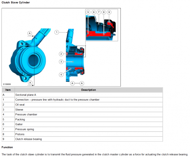

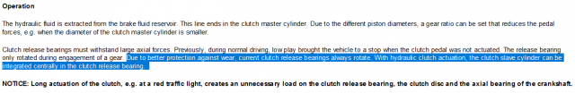

I hadn't made that point but think I would've agreed with you. But interestingly, something else in the manual caught my eye after posting last night; particularly the function of, and interaction between release bearing and slave cylinder.
What happens if this integrated, always rotating, release bearing, is bad? It gets pretty damned hot. (this can happen without it squealing or locking up) What happens when it's constantly hot? Extreme heat ain't good for the spring, seals . Given the description of its operation, there a few different possibilities that (theoretically) could result with the clutch pedal being stuck on the floor.
* Boiling/vaporizing the fluid in the slave cylinder
* Piston binding
* Seal leaking pressure
Some or all of these could theoretically occur. Re seal leaking pressure, that could only be the case if the pedal is stuck the floor *while* the engine/trans still have some engagement. (so it's stuck to the floor but you can still slip and/or accelerate)
Agree? Disagree? Partly agree? Additional considerations?
* Piston binding
BTW, with any and every clutch I've owned, I've always held them in at traffic lights. So far not an issue out of any of them. Only part needed to replace thus far is a leaky master cylinder on the firewall of the previous car.
Huh I never read those pages in the shop manual, or couldn't find them. Interesting.
I can't relate on the holding the clutch down at the light, I have never ever done that in any of my manual cars. But yes that would cause excess wear on the bearing and heat everything up. However cooling the fluid itself wouldn't help, not without a way to pump it through the system.
I wonder if the majority of people with this issue do hold the clutch down at lights... None of the people in my household do this, and none of our fiestas ever had this issue.
