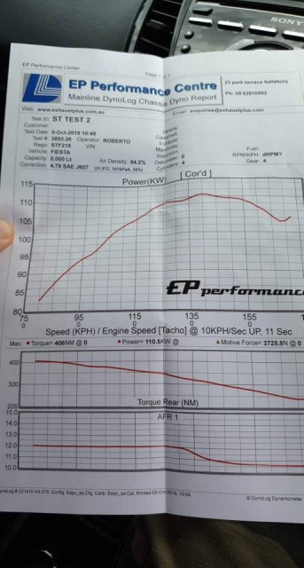

Hey guys, new guy from Oz. Took my car in for its first dyno.
As you can see i only made peak power of 110kw at wheels!
I had calculated i should have closer to 140!!
That number is worse than stock.
I have the following mods

I am completely confused, my boost reads about 21.5psi and car feels fine.
Any ideas? Torque numbers look okay?

It would be helpful if the dyno had the RPM where the max Powers were made. You are getting 300 lb of torque but at what RPM.
Would you still make 300 pounds of torque with a boost leak?

Car looks like it got very rich halfway through the pull. Looks like 10.5:1 but hard to read that graph.
EDIT: Mainline dynos are load based like mustang dynos. They will usually be much lower compared to dyno jet (inertia based). Your numbers looks similar to mine using the mustang dyno correction factor of .09 on vdyno and I'm stock on E30. I suspect a pro tune would net you better results assuming you have no hardware issues.

Looking at your graph again it seems like your power drops off pretty dramatically around the time you start running rich (too much fuel, not enough air), so I could see a boost leak being the culprit, or there's something wrong with your tune.
