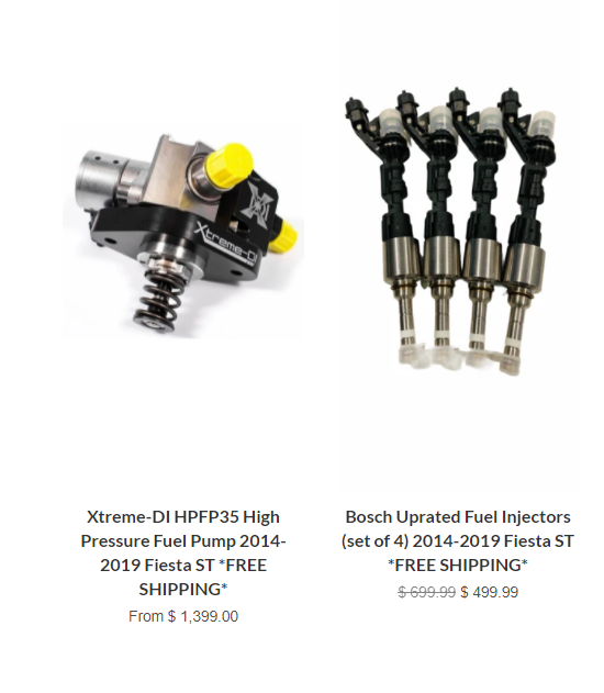

thanks,
that's the current XDI 35 HPFP and 30% injectors
there is an XDI EVO HPFP and 50% injectors not listed on the site yet and really woud not be needed unless north of 400whp
Worth it on an S280 tuned for 93? I'll be your test dummy if you want. I've got Dyno time upcoming....
