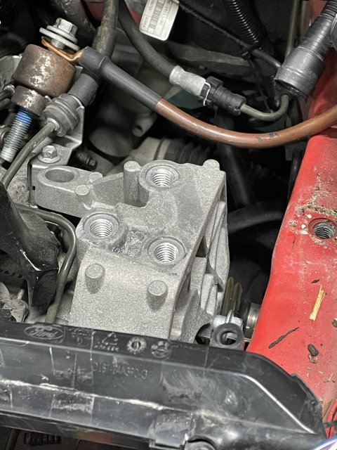

Well this was an incredible pain in the ass and way more time than it should be. IMG_3981.jpeg 73017052893__B8469A98-CD6A-4FAE-9574-CADB7A383525.jpeg
The trans mount studs are pressed in and crimped in place as far I can tell. Removing them was a massive pain. I will let ya’ll guess why I removed them.

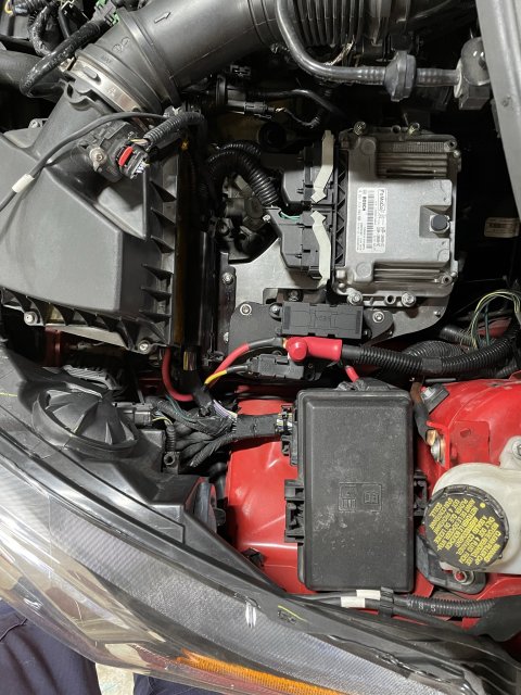

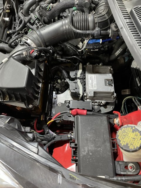

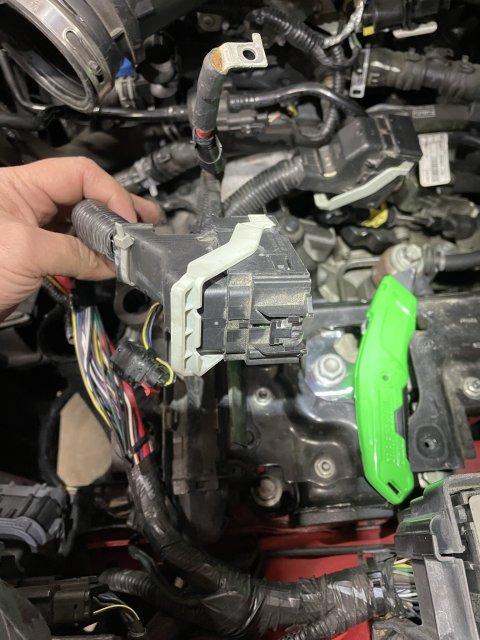

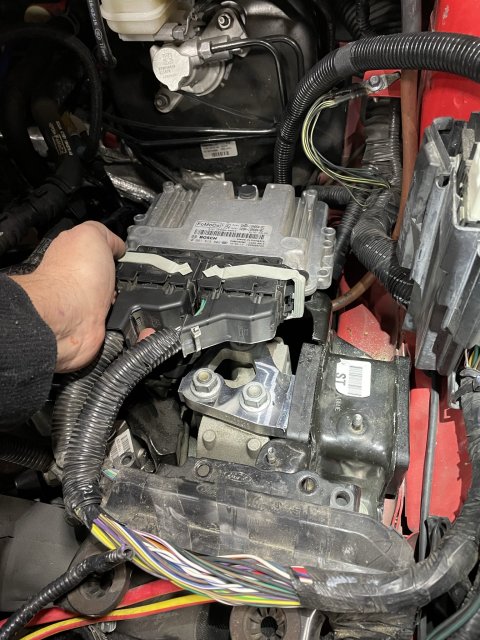

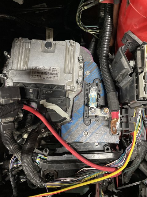

This is the final iteration of my ECU and fuse mounting plate is coming along. This will clean up all of the battery box area

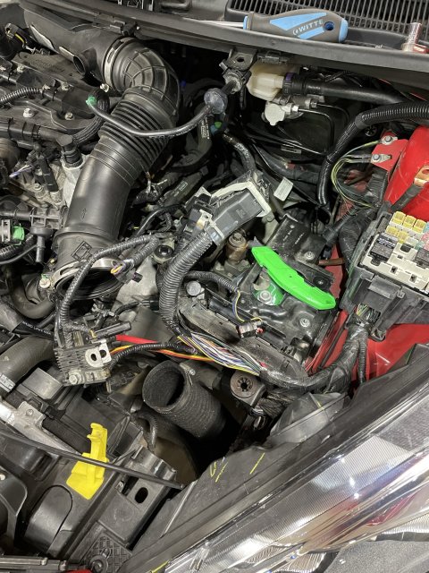

Ok its been a busy while since I have updated this, but a lot of parts have been made in order to get the car on track for Gridlife.

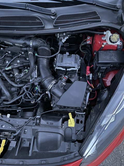

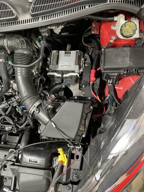

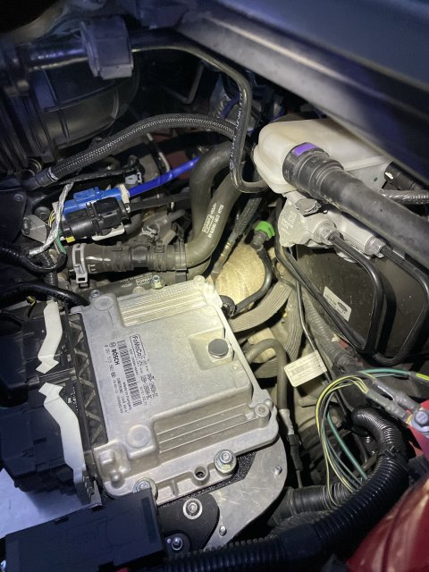

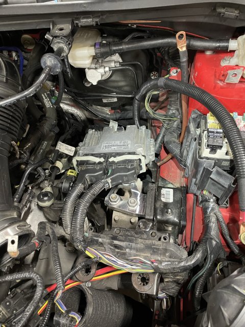

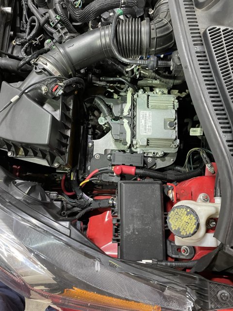

I mostly finished the battery relocation and wiring clean up in the engine bay. I need to run one wire to the back where the battery is to connect all the battery sensors directly to the battery for now they are just tied up in the engine bay not connected. However I have no check engine light because of it either.

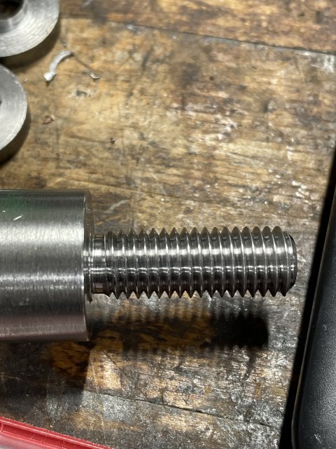

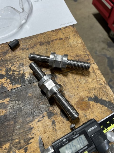

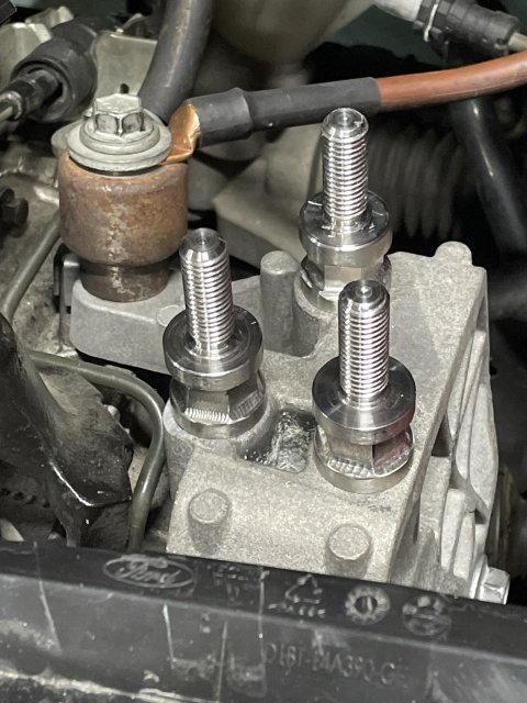

I spent a ton of time on lowering the engine. It was a ridiculous amount of work for probably a minimal gain. I made custom 1in stainless spacer studs to go into the OEM transmission mount on the case. Removing those OEM studs was a massive pain in the ass, they are cast in place I think.
IMG_3981.JPEG 73170698132__4384968C-488A-47CB-AF6F-FBF7F6907E9D.JPEG 73195541809__8C2136B8-421F-477B-9A66-39CCFE4AD5BC.JPEG 73196304918__B4283990-F0D7-4A2D-98CC-128A084B9EE4.JPEG
The studs are 17-4 stainless, cuz its stupid strong and I don't have to deal with zinc plating it. These in conjunction with some aluminum spacers and longer studs on the drivers side bracket worked out pretty well. I had to build a custom dog bone and change the angle on my down pipe to rotate it up into the tunnel, which I wanted to do anyways. Doing that cleaned up the exhaust I always felt hung down to far.

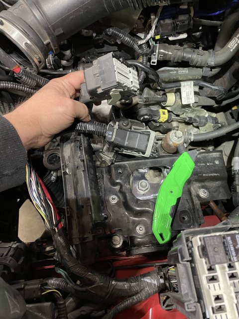

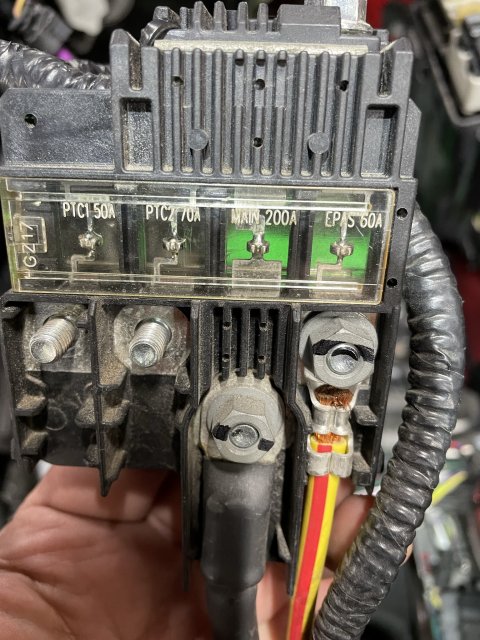

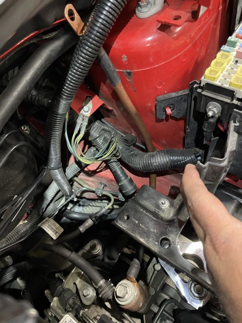

Some more pics of the electrical clean up:

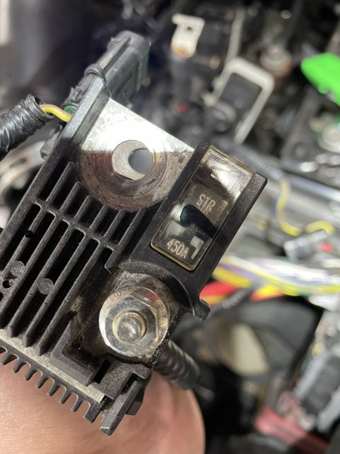

There are still the proper fuses setup for the main fuse box and the power steering. I still need to attach the huge 450amp fuse at the battery, but I have never had an issue with the run from the front to the back so its not a huge priority.
The two little wires are the transponder wires that run up from the splitter where I have it mounted. They get connected to power and ground when I am running an event that has timing and scoring.

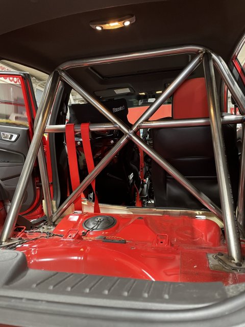

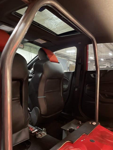

Thread Starter #196

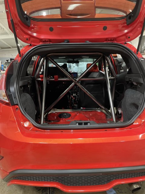

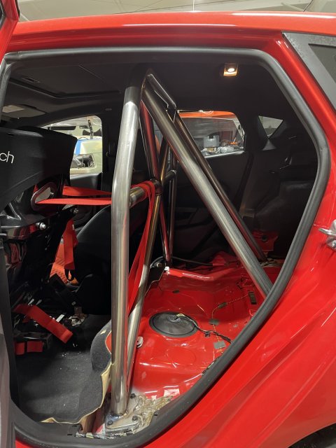

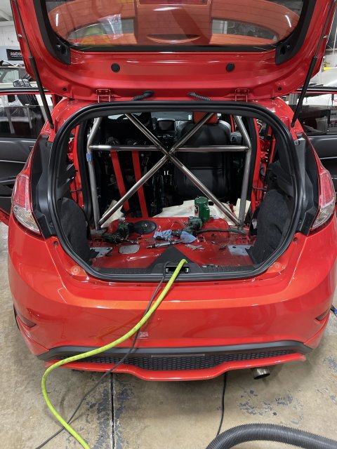

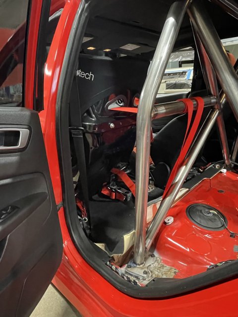

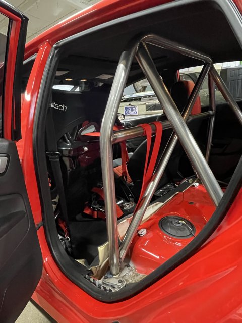

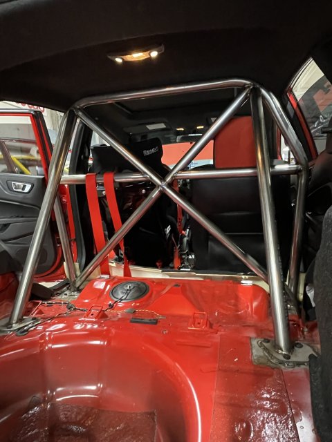

Also built and installed all the proper safety equipment. Built the roll bar to SCCA regs, but its all Docol R8 tubing that was TIG welded with the proper filler material. Its bolt in, because I have a sunroof and I probably will have to remove the damn thing in the future to fix a water leak. I can also now get it powder coated. I welded plates to the floor with weld nuts behind them. Then bolt the roll bar to those plates. They tie into much stronger chassis points than the sheetmetal of the floor and the fender wells. I actually reused one of the rear seat anchor bolts along with the three other mounting bolts in the rear down legs. I haven't weighed it but its probably about 45lbs.

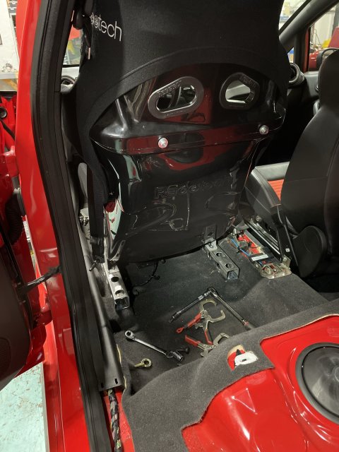

Thread Starter #197

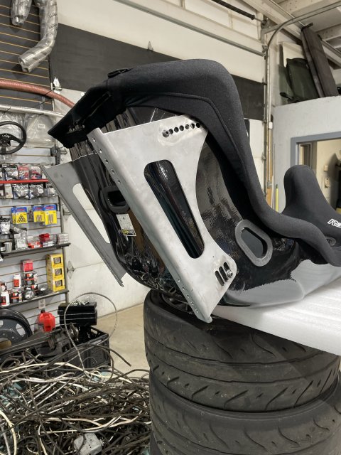

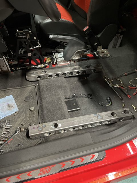

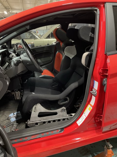

While building the roll bar, I made some lightweight seat mounts for the Racetech seat and Racequip harnesses. One thing I like about this seat are the proper holes for running a real six point harness the way it should be run. So many modern seats are actually designed for 5pt harnesses which aren't as safe in my opinion. These mounts weigh a third of what those stupid Planted seat bases weigh. The side mounts were some I designed for an RX8. They sorta worked here, but after being on track my butt was too low and I had to put a towel in the seat to get my eyes up above the wheel rim. I think I will add a hole to use a different style side plate to get my butt up a little higher for better visibility.

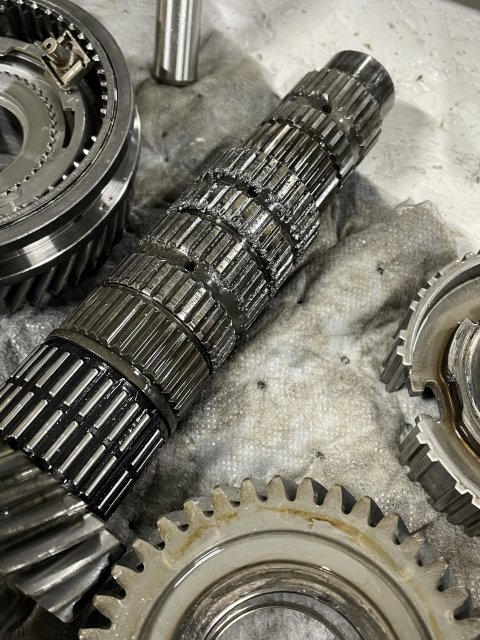

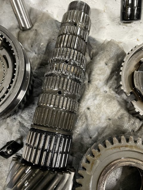

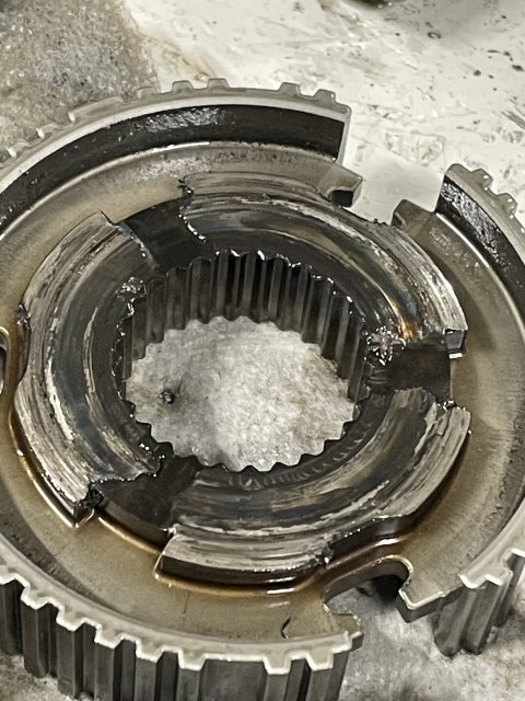

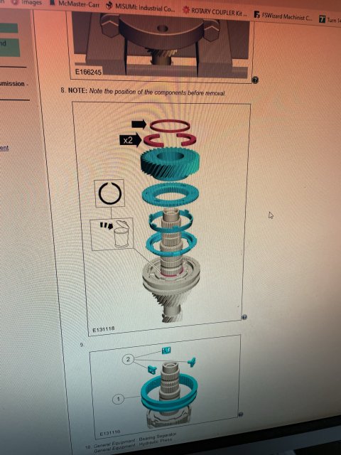

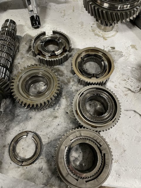

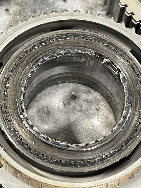

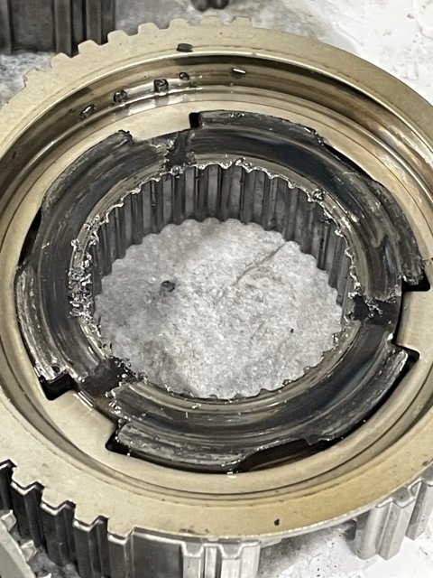

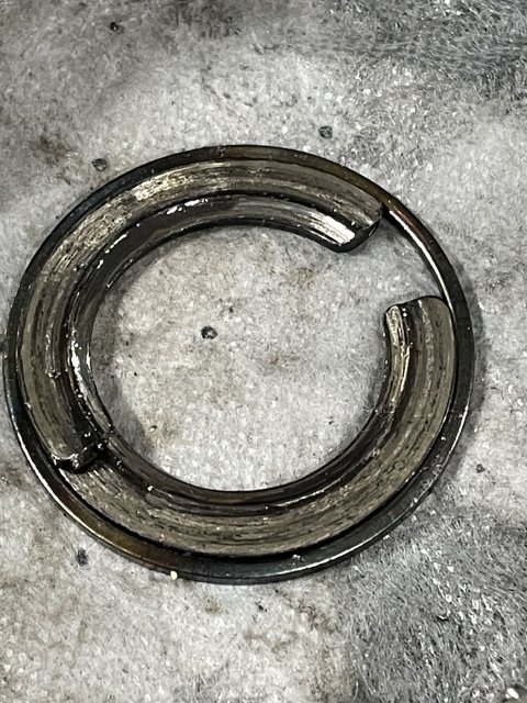

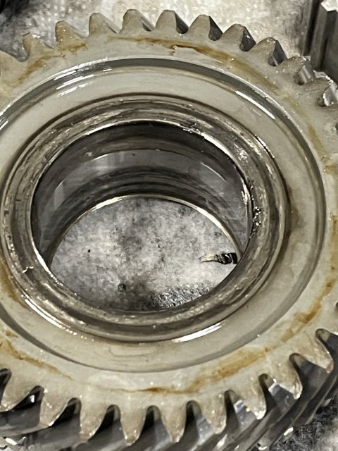

Well Shit. This is the 3/4 hub, gears, slider, syncros, input shaft, etc. I am starting to think the lower pink snap ring behind the 3rd gear somehow got loose, probably due to me forcing the shifter when the two little dog bones on the shifter rattled loose on track at Gridlife. I have some spare parts from the Fusion trans, but its still gonna cost me a few hundred to fix this because the two snap rings from Ferd are $90/ea. WTF. How are two snap rings almost $100 and an input shaft is $54?

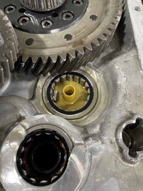

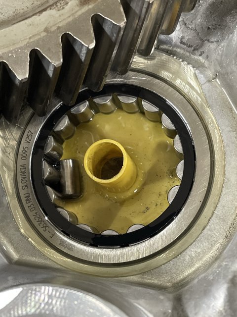

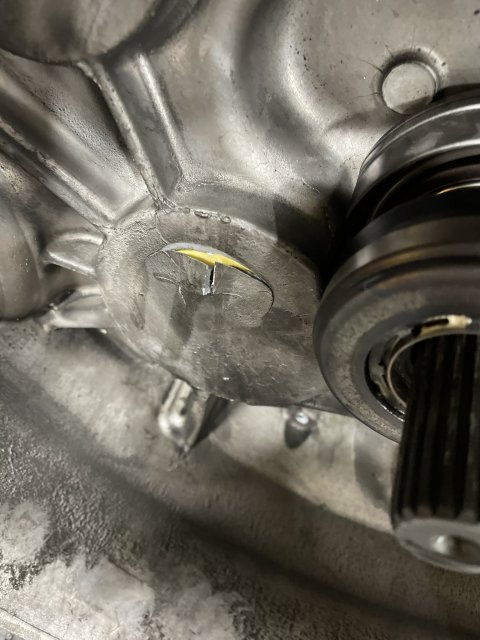

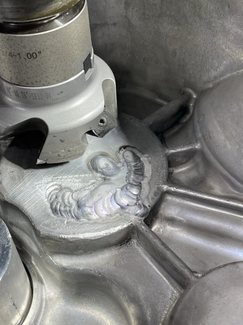

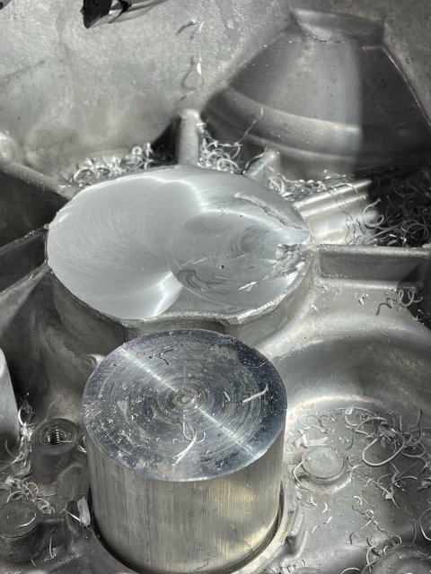

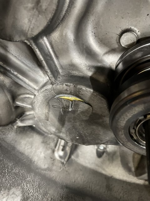

More than a month ago I was reassembling the case and just about ready to wrap that part up, when "crack". "Aw man WTF"?
73974996195__26A5AE11-9D6E-4257-95EB-9F90D96E8143.JPEG 73975059852__652F9286-3579-4C7D-8130-5A102EAE509D.JPEG 74078682394__0271098D-26E9-4388-8CB5-7BFB2EA02C8A.JPEG
Somehow I knocked one of the countershaft bearing rollers loose and it wedged itself between the case and the snout of the countershaft. When I tightened the bolts up (by hand) it punch through the end of the case. Dammit. I can't win. So get that welded up and machined down, then I am waiting another month for the damn parts. Getting parts for this trans repair has been the biggest headache of my life. They have taken so long to get in hand. By this point I am tired of this damn car, so it sits.
