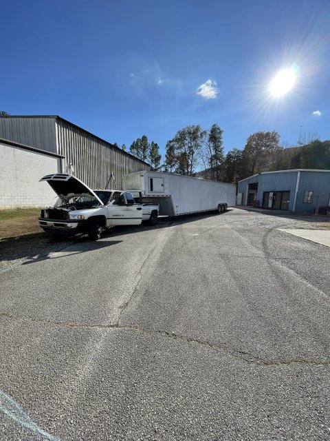

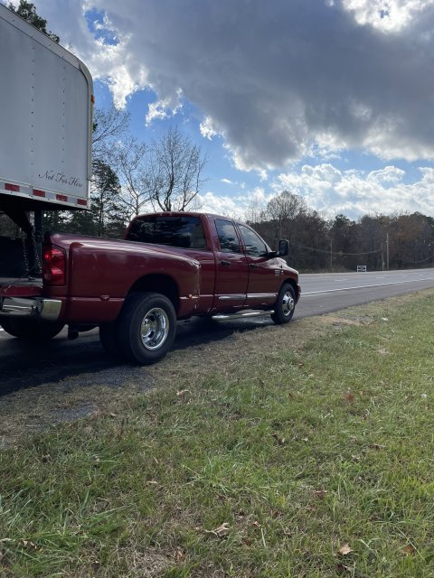

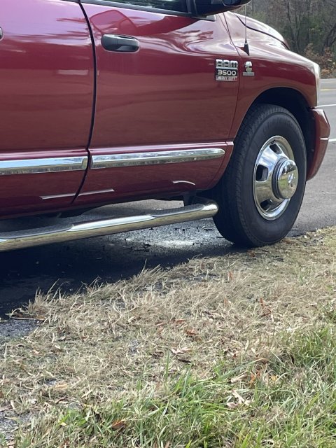

Well my weeks of working late nights and building all new parts was for naught. Worked till 0200 this morning to finish the car for Barber, got the last bit of the alignment done by 0900 and loaded the trailer. Headed out and made it 30 miles down the road before the new truck's water pump failed in spectacular fashion.
Had to rescue my trailer from the side of Highway 431 with my trusty old V10 Ram. She has been a solid truck for 15 years. Unloaded the Fiesta and backed the trailer into the gate and locked it up. Fuck it. I am done for the weekend.

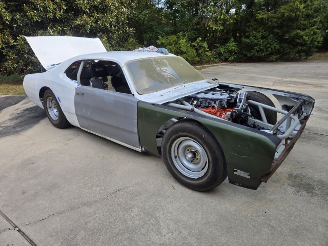

See, I bought a cheap fiesta with an autopower bar, whoosh suspension and thermal catback because my street legal nascar was turningintotoo much work.....
Get back to work on the Duster. Also take that damn LS out you barbarian. Chrysler makes good engine and you have plenty of room in there for all kinds of hemi or V10 powered activities. An R7 would look beautiful in that engine bay.

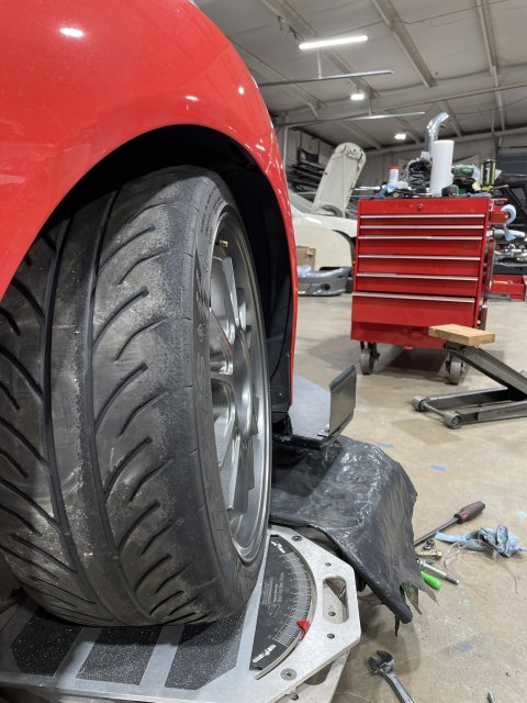

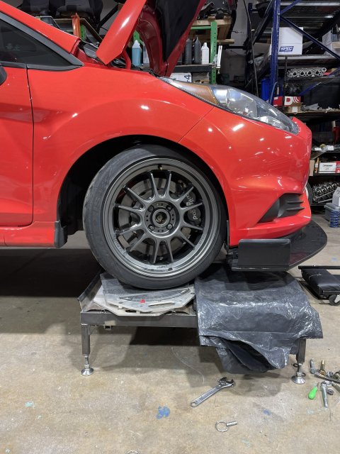

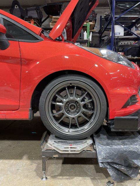

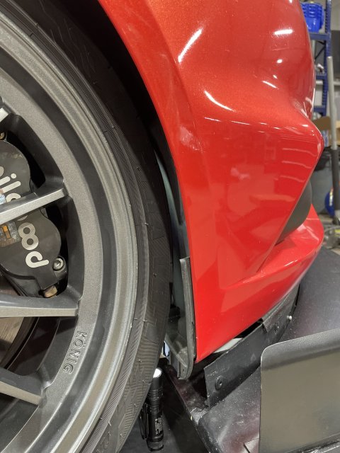

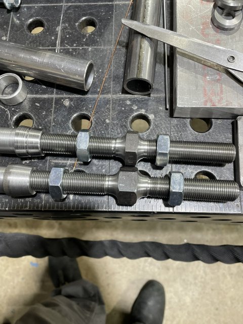

10deg of caster and -3.5deg of camber. It does clear the fender liner.
I had set the car up with 650lb front springs and 700lb rear springs, swapped in the track pads and all I got was a drive back to the house in traffic. How lame. maybe this week I get a clean lap up my test road. Car feels different for sure. I am surprised how well 650lb springs ride on the street. LOL

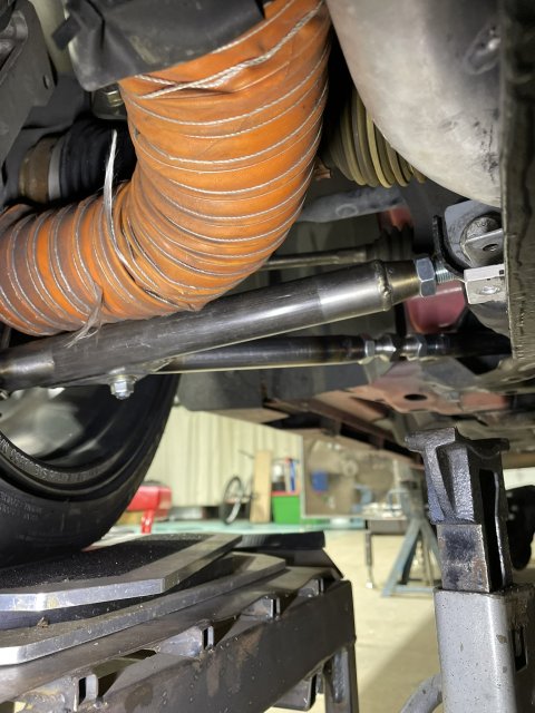

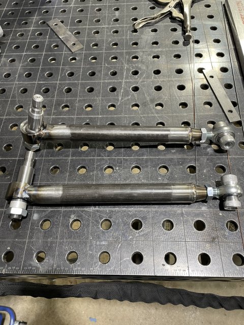

That’s pretty cool - did you use rod-ends in place of the balljoints, or something else?

Love those control arms, eliminating all the soft rubber is a win alone, now you have forward offset, more caster and camber what a win! I ran a similar setup on the fox. (try to get as much of the engine behind the front axle line as you can)

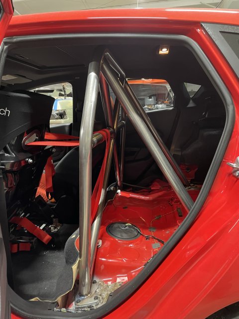

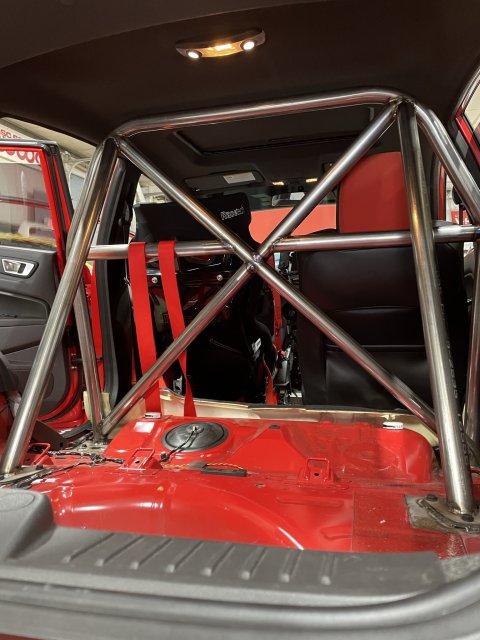

Amazing build, How do you like the autopower cage? Do you still have plenty of room behind the driver seat to recline and street the car comfortably? Im planning on ordered the autopower even though I dont like how small the foot/plates are.
Cut the foot plates off and make it shorter? Weld it to the top of the back seat shelf? Or talk to your local fabricator about bending a custom roll bar and mount it where you want it. You can use a better material than the DOM Autopower uses.
Not shorter but larger, larger contact patch like a 6x6 inch piece of steel.

Don't mount it to the sheetmetal on the floor if you have the option. Its not worth the risk. Mine is tied into plates welded into the OEM "frame rails". Yeah its removable, but its tied into the hard points on the chasssis, not sheetmetal like Autopower does.

Thanks really nice, but i dont have the option to mod the autopower cage.
