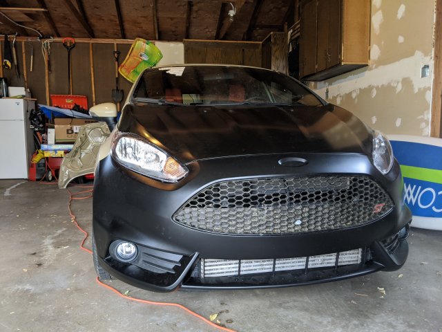

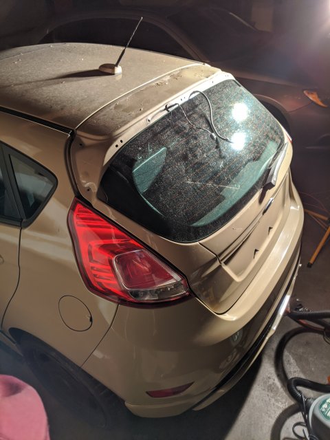

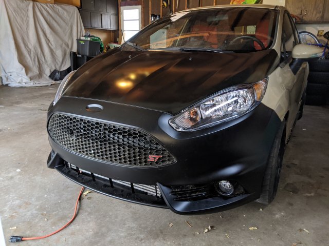

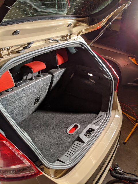

I finally got back from my trip and I spent some time last night cleaning up the leftover glass pieces around the trunk after the guy replaced the rear glass. I also put the whole trunk back together.
I was also able to lift up the car and everything within the air suspension is working great. It was nice to see it a bit higher so the tires don't rub :)
Now, what is left?
-Hood -- it won't fit in my car so I'm trying to get someone to help me with it today.
-Rear spoiler -- The aftermarket one that came with the car used different screws so I need to source new ones
-Tires -- I need to find wheels/tires that will fit my calipers in the front very badly. This is the only thing stopping me from being able to drive it around at the moment
-ABS programming - I stil have the issue with the ABS, the car runs fine but after going 15mph or so, ambien temp indicator turns off and airbag lights turn on/
Once I'm able to find new wheels/tires the car is going to Ford for diagnosis. I'll also start looking around for paint quotes for the hood and bumper but I may try and do the hood myself though.

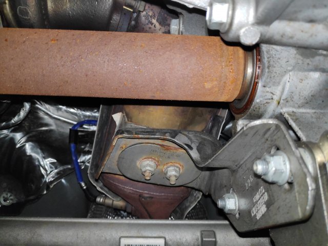

Alright so I got a chance to get down and saw the following parts broken:
1. Control arm
2. Inner and outer tie rod
3. Sway bar link
4. Front axle
This should be fairly easy to fix up

For sure new arm and tie rod. The axle may ha e just popped out of the transmission. Lets hope it didnt tear the boots up. As for the clutch perhaps there is air in the system and it needs to be bled?

Lopks loke the half shaft just rubbed on the swaybar. Id send it until the axle starts making noise. In the meantime you could pick up a replacement if she is able to run so that way come spring you can swap it out.

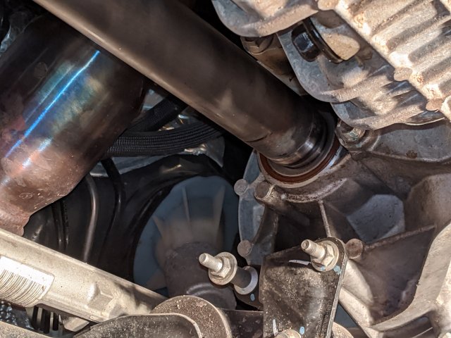

Thread Starter #76

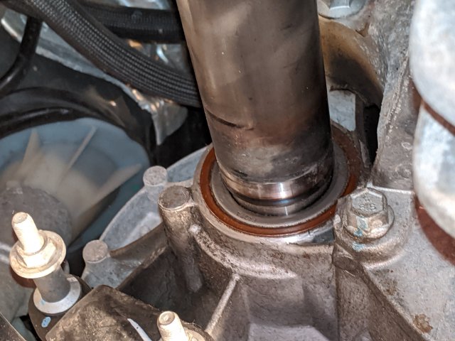

Just updated my post with today's update! (in the first page, post #2)
I was able to get the front halfshaft in place but I'm wondering if it looks like it wasn't put all the way in? The bearing is aligned with the metal bracket but it just doesn't look all the way in but I may be overthinking it.
PunkST
#4388
2,239
1,418
#77
It doesnt look 100% seated to me. Hopefully someone else can show a close up pic tonight. If not then ill grab one early tomorrow for you. This is the passenger side yes?
