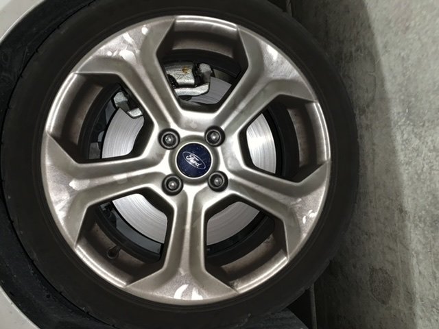

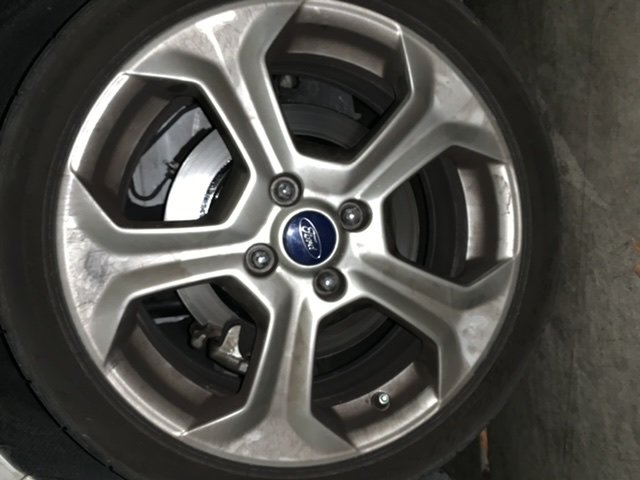

So I shimmed the front brakes and the right rear and put everything back together. Man was that a pain in the butt cutting up cans and getting everything in there. I also spray painted the rotors and sanded them a bit to re-bed the brakes.
I’m happy to report I now have nice even wear all over the rotors and now with the extra paint have no rust strip near the hubs where the pads don’t contact the rotors. I also re-greased the slider pins with silicone grease just to make sure the brakes would engage correctly.
After bedding in the brakes again the grind was back in the front once hot. When the brakes cooled some I had no more grinding. It’s frustrating but whatever. Maybe the calipers are sticking a bit due to my fluid being old. I’m going to flush out the old fluid next weekend and see if that helps. I did have some wear on the bracket on the right front, so hopefully the shims help there.
I also found that my rear driver side pad was not lined up right on the inside due to the wear pattern on the rotor. Tomorrow I’ll see if that was fixed when I wound the piston back in and reseated the caliper on the rotor.
