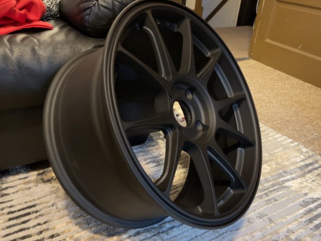

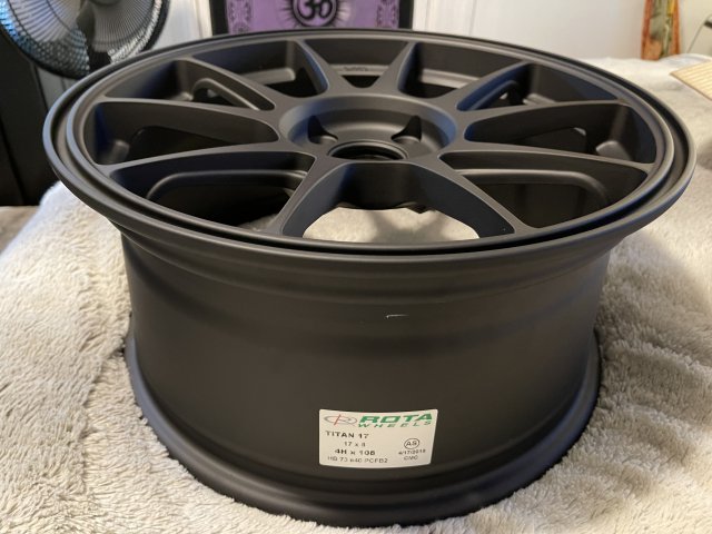

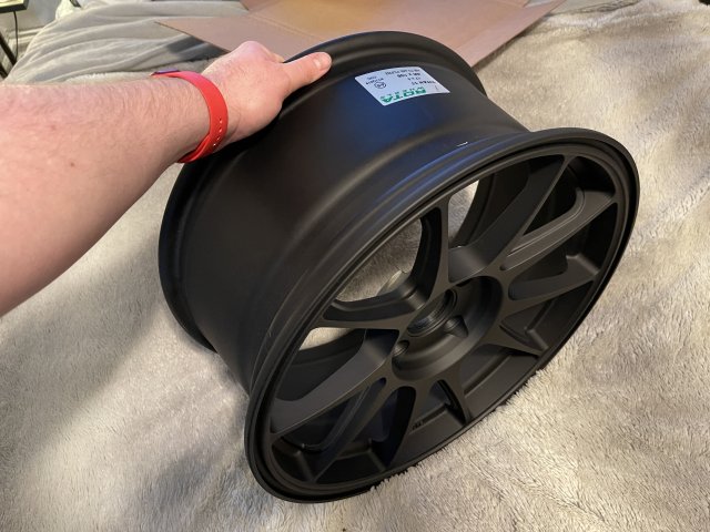

Just showed up today. Last set of 17x8 4x108 +40 flat black I could find. Already installed the hub centric rings in them, just waiting for tires to come off back order

Hey guys, quick fyi. I have these wheels in 17x8 with 215/40/17 yokohama neova AD08R's. I'm on mountune springs and rub slightly on compression on the plastic wheel liners right where it sits next to the fender lip. Rubbing occurs more on compression when going over dips at speed than in turns. Currently around 1.2 deg neg camber and I'm not really sure squeezing more camber is really going to clear the tires of the liner. I may try it or just trim the liner back. Also the yoko's have a much more squared shoulder than the stock tires in addition to being much wider so that doesn't help.
If you get these wheels I'd suggest running slightly narrower 215's or more camber (coilovers w/ adj plates would help here). Anyways, the issue is very slight but I thought ppl would like to know.

Pros:
  • Look amazing
  • Hub centric and 17x8 fitment (from what I gather this is quite rare for these wheels)
  • Light at 16.2 lbs per wheels
  • Seem to be structurally well made
Cons:
  • Center caps come off the front due to tabs melting from brake heat
  • Finish is quite poor as they flake pretty easily from road debris. Also the spray on the inner barrel is quite thin and inconsistent, like they didn't do multiple coats
  • Mine also came out of balance last year. Not sure if thats a wheel issue or due to roads around here but worth mentioning
I like them and I still think they look really good on my car, but I am thinking about selling them. Mainly due to space (I have 6 sets of wheels and tires between my two cars!) and I dont use them as much in the summer as I thought I would.
