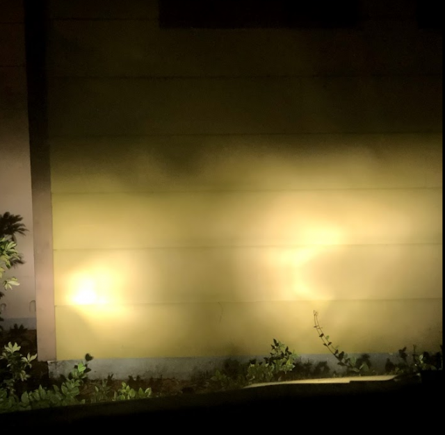

I sent a message just now. For reference, here is the issue I'm having with it. There is a weird "hole" in the output of the right lamp.

Hmmm, I was expecting to clearly see half of a beam of output from one side of a bulb missing, that almost looks like you may have bent the glare cap on the right side... If you switch the bulbs around what do they look like?

I didn't switch them around, but I rotated the LED stick around in the housing and the dot moved around with it so I figured it was an issue with the light and not the headlamp housing itself.

OK, remove from the housing but leave the wire plugged in and turn on so you can confirm that one side of the bulb is out and go from there... sorry, didn't mean to worry you, but that looks a little weird but it might when one side has gone out....

Well they said they would replace them for me. So hopefully that'll solve it.

So I switched out the right high beam and the issue only seems to have gotten worse, so it just be on my end. Now you can't even see it on the street while driving. Any ideas?

I was saying earlier to pull out the bulb, leave it connected, turn them on and double check that both sides work, so I guess they are working... My next guess is you bent the glare shield where the tip of bulb rests into, compare them on both sides...

And I feel stupid now, of course the H1 high beam doesn't have a glare cap, but I have an idea, humor me and follow along... So I just installed these new higher power "60w" Aukee (the original recommended ones are "50w") since they were on sale for only $25 even but now they aren't even available on Amazon in H1 any longer... That's too bad as these are fantastic, now the next step up in Aukee H1 is a full $60 for the "110w" ones... Anyway, theses "60w" have a nice solid plastic mounting ring that twists and locks into place on the bulb, there is no twisting adjustment at all. There are also 2 little bumps on the ring to sit on the housing nice and straight and was able to get the clip on OK, once I realized how they go back in, hehe... but with how the bulb goes on, it twists and locks into place and the stalk sits at about 45 degrees and works great... so for those wondering, LED H1's for high beam DO sit at a 45 degree angle for best results... even my original cheap crappy ones I can see sit in at that angle too, at the time I though they were wrong!

The 45 degree idea might just work. I'll give it a go cause mine are completely verticle.
