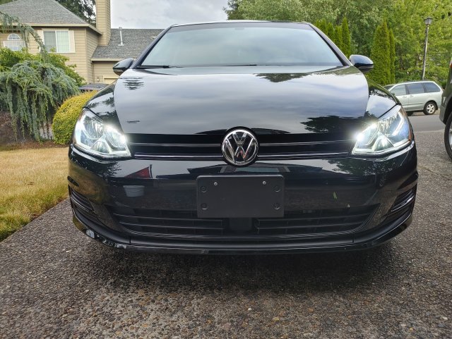

Quick update, when I traded in my FiST for a my Golf I transferred my Katana's from my FiST Euro projectors over... Funny, it's the opposite than the FiST, the low beam needs an adapter if you don't want to use buy expensive VW proprietary power connector type H7's and the headlights are a bitch to remove but ultimately was worth it... I did find cheap direct fit high beam/DRL's so no adapter needed there. The Golf halogen housings are incredible, there is actually almost a hard cutoff and no light leakage out the side either, didn't have to adjust headlights at all!
