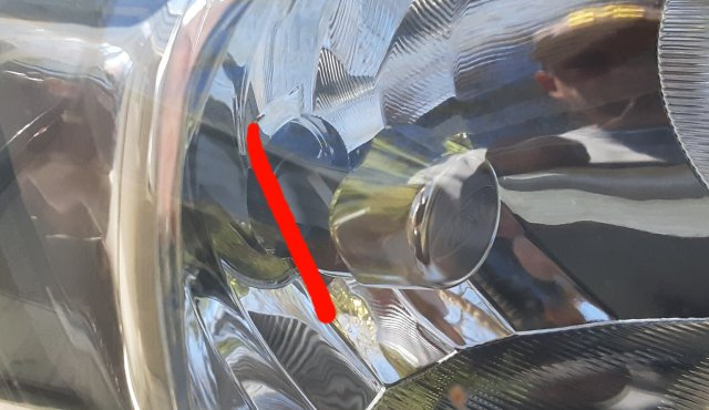

If I recall, my Gen 1s are orientated per your picture (where they're pointing up). That was the only way for me to get them to easily lock into place with the LEDs correctly aligned.

Ahh sorry for the confusion, I mean the design notch where the LED sits, should the v looking be facing up or down or does it matter? Thx guys!
The bulbs have been designed in such a way that if it clicks and locks then that is the direction of where the bulb position should be. So just take it as default and you'll be fine.
The "blade" the LED sits in needs to be vertical. There are only three possible rotations; vertical is the magic alignment.

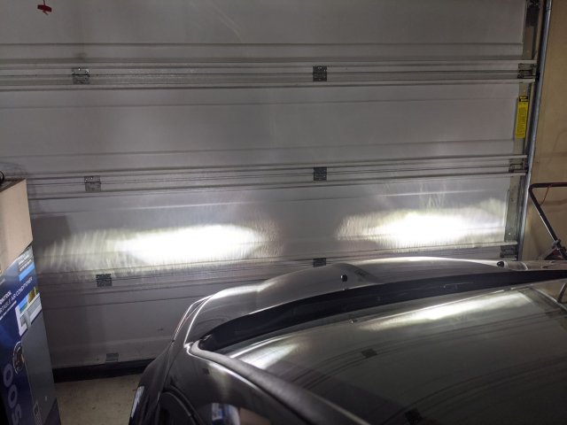

Picked up a set of Euro Projectors, have Cougar Motor X-Small in the low beams. I'm a newbie in the headlight department and LEDS, does this pattern seem acceptable? It's from about 25 feet out but I believe I might need the right side to come down, and the left side looks a bit off? Any insight would be great!

At first glance it seems to be ok. It is like maybe very ever so slightly higher on the right side but that is still acceptable. The cutoff is good.

These fit & work perfectly....align so the blade is vertical (there are only 3 possible rotations...vertical is the only one that works)...TECHMAX Mini H11 LED Bulbs.
