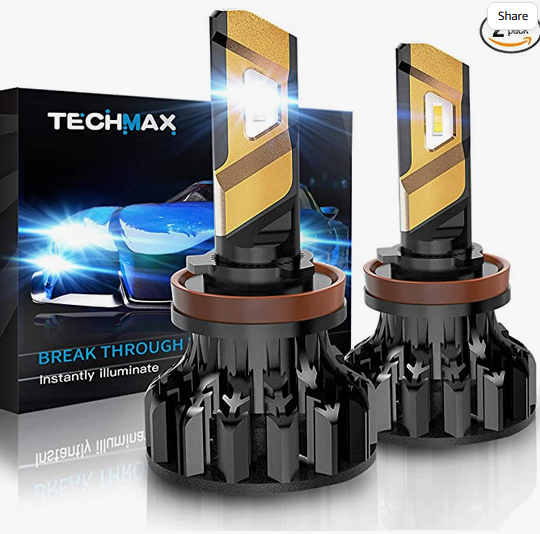

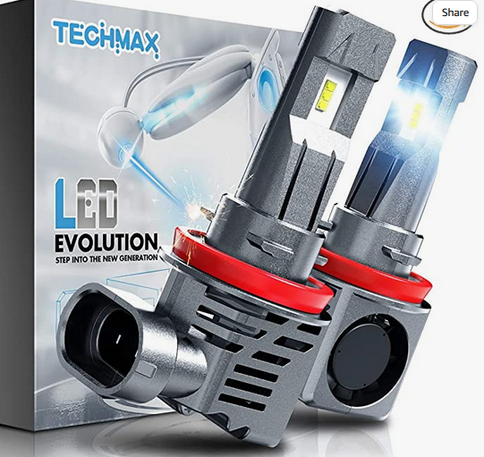

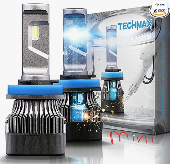

Which techmaxs are you talking about? There are three different kinds being discussed here on the forums and many times nobody distinguishes between them. The Techmax Small Design fit no problem. The Techmax Gen 1/2/minis require modifying the housings if you have the USDM style housing.
I ordered all three kinds and I can say with certainty that only the small design will fit without modifying the housing if you have the USDM style housing. They go in quickly and easily, just like a standard H11.
I actually managed to get the gen1/gen2/mini into the socket but there was so much pressure from the housing clearing issue that i couldn't rotate them at all. The housing contacted the fan assembly and pressed the whole bulb assembly into the socket hole with a lot of pressure. The fan wouldn't spin because of the pressure.
And to be clear, the dust cap isn't the issue. The housing itself is too short to allow the length of the techmax's to work. The fan assembly collides with the housing and doesn't allow the bulbs to be inserted. Unless you've found some insertion method that works, in which case please show us how that's done. You replied to a comment that had photos showing the issue so you're aware of what I'm talking about. https://www.fiestastforum.com/threa...b-info-finds-and-discussion.18114/post-457659
Small design - https://www.amazon.com/dp/B07WNVVSNK
Gen 2 - https://www.amazon.com/dp/B07RJN9SPV
Mini - https://www.amazon.com/dp/B07C1LTQ92
Pretty sure it was the Gen1 Minis*

Techmax Gen1 minis with the Blue Sealing ring* Don't worry about some ass hat who didn't install them properly and used a hammer to put them in. I ran LEDS for like 30k No issues and even installed the OEM Dustcaps. You will be ok buddy!
Use those. No mods, no melting, no issues.
Don't bother trying to find which ones are gen 1 minis. Just order the small design.

Yeah those dont fit into my housings and a few other people said they dont fit. They're the same length as the gen 2 but they're not as wide. I know because I had both of them in hand and they were pretty much the same length. I put the Gen 2s into my fog lights and returned the gen1 minis.
Looking at the amazon reviews, techmax themselves say the gen 1 minis will only work in the fog light. But customer reviews say they'll work in the low beams.
This thread has a ton of conflicting information in it. I'm curious if there's maybe 2 different USDM housings? Or maybe techmax has different products under the same model? idk
here are the product dimensions as stated in the specs.
Gen 1 mini: 6.1 x 5.51 x 2.17 inches
Gen 2: 5.9 x 5 x 2.5 inches
so yeah really not much of a difference.
Small design: 4.65 x 4.57 x 2.28 inches
