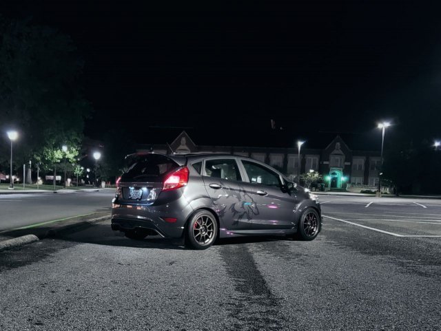

I've got to admit, these new tires are amazing. I had a chance to go out on track today, this thing corners like it's on rails View attachment 31582
205/45s?
Just imagine if they were a 200 tread wear gumball, they would lift those 'rails' up with the car on every corner! LOL

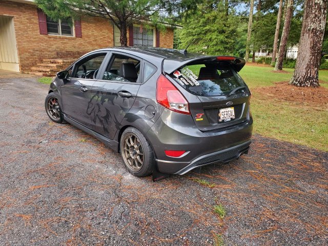

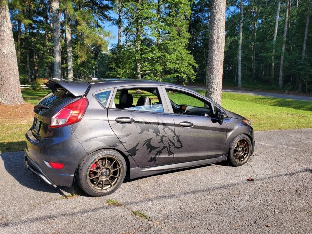

A few minor changes, I peeled off the old decals, my custom ones are in. They ended up a little small, but I like them. It matches the theme with my license plate now! IMG_20200730_014154_782.jpg IMG_20200730_014227_291.jpg

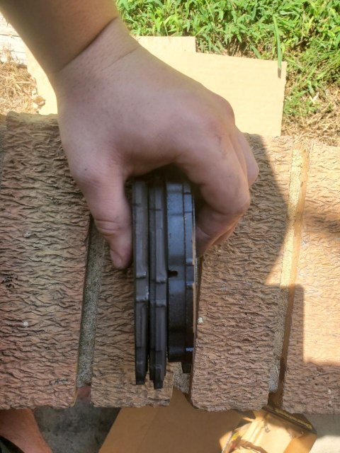

You did not get 65K out of the original factory pads, did you?!?!! [crazyeye]
I did on the fronts, the rears had a pad failure at 49k.
these are the front pads, they didn't have the little 'squealer' tab I'm used to
#3304
11,856
8,309
I hope that this is a comparison of old to new* [wrenchin] Those are still good! You still have the backing plates to grind down too!
it is! They didn't make noise until I had to do a panic stop, then all hell broke loose. There was friction material left, but only just
shouldbeasy
#1098
1,469
825
I waited for the noise - turns out the noise I heard was the metal backing plate!!! I had used up ALL of the pad... First time for that one!

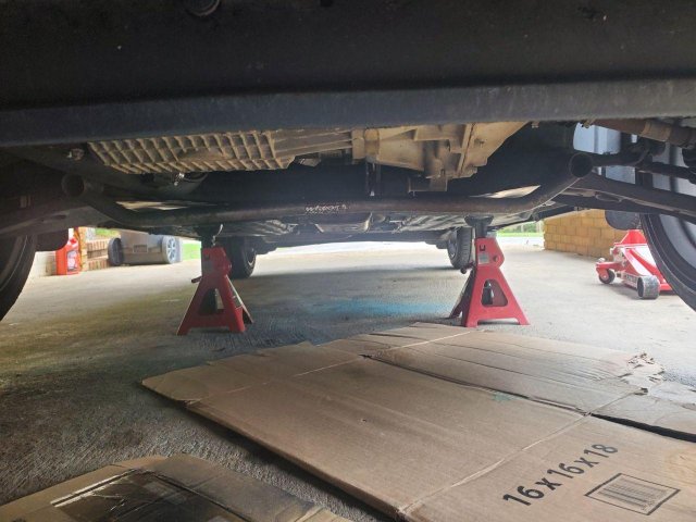

Did some more maintenance today, I still have an oil leak from the turbo drain. The oem turbo used M6 bolts and the MRX uses M8, and since one of the step studs broke I decided to modify the oil drain pipe. I drilled the flange for the larger bolt, and modified the gaskets. Now instead of studs I have M8 screws going directly into the turbo. It worked great but leaked, so today I added a new oem gasket and some permatex. Also while under my car I got a picture of the 2 point brace, it has taken a battering. It's bent up a large amount in the middle, but other than 2 dings in the resonator the underside of the car is in flawless shape.

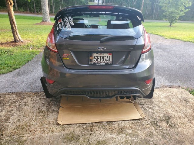

Inspired by other threads on here, I shaved my rear bumper. It looks good! Note, the mudflaps aren't screwed in in this picture
