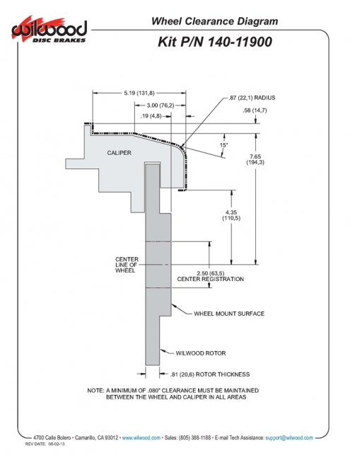

do they clear the wilwood F&R easily or do you need spacers?
Not if it has the same inside diameter as the 16x7. I just got the 16x7+43 and they will clear the front wilwood(12.2" rotor) with a 8mm spacer, but the rear doesn't fit. Not even close. The inside diameter of the wheel is about 14.25", and it needs to be 15.25" to clear the 11.75" rear wilwood kit.

Not if it has the same inside diameter as the 16x7. I just got the 16x7+43 and they will clear the front wildwood(12.2" rotor) with a 8mm spacer, but the rear doesn't fit. Not even close. The inside diameter of the wheel is about 14.25", and it needs to be 15.25" to clear the 11.75" rear wilwood kit.
I heard you can fit them if you trim the handbrake cable bracket flush. Theres a thread on here also of someone running 16x8 with wilwood f&r

I heard that too, I was told that by someone who said he fitted the wheel. I think it's the red Fiesta pictured at the beginning of this thread, which has a 16x8 4x100 wheel (I don't know the offset)
All I know is the wheels I just got are 1" too small. Maybe the 16x8 has a bigger inside diameter? I would recommend getting some solid measurements to make sure.
Have you tried fitting them? Slide them on then check where they are hitting (is it the handbrake bracket?) did you use oem hand brake line or the wilwood one?
Sent from my VOG-L09 using Tapatalk
Yes, I tried fitting them. The inside diameter of the wheel is about 1" too small. Nothing to do with the handbrake bracket
Edit: the inside of the wheel is 14.25". If you take a look at the wilwood diagram, you should easily see why they don't fit
The 16x8 must have wider internal diameter because ive seen 2 people running 16x8 now with wilwood F&R, do you mind posting a thread with photos of front clearance?

Are the 16x8s they are running the Dekagrams, or did they definitely do the 4x100 re-drill and use something else??
IF the Dekas, do the front Wilwoods fit with NO spacers?
I told you all I know in my first reply, take it for whatever that’s worth to you. I don’t have any pics of the front wheel clearing the caliper, so you’re just going to have to take my word for it, or not. I have a plan to use smaller rotors on the wilwood kit to clear these wheels, and potentially 15s as well. I’ll post something up if/when I put it together.
