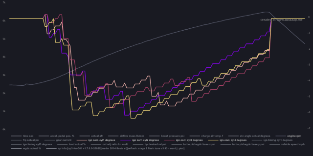

Here is an original data log: https://datazap.me/u/plisky/dizzy-stage-2-old-plugs?log=0&data=7-9-10-11-12

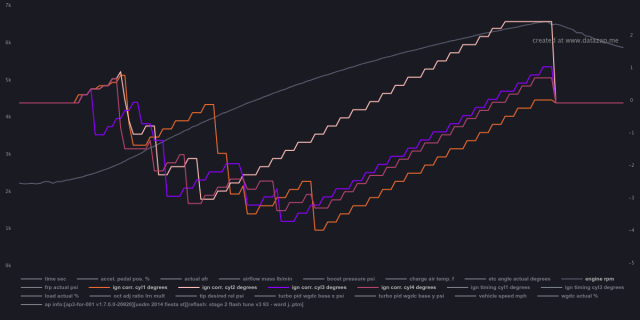

and here is another after the new plugs, coils, and cleaned intake valves: https://datazap.me/u/plisky/dizzy-s...s-and-cleaned-valves?log=0&data=7-10-11-12-13
