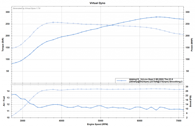

Finally got my boost issues addressed thanks to @ron@whoosh. His customer service is top notch!
I wanted to give an update on progress so far. This is my 3rd revision on the new turbo. 93 octane and single port aux fuel.

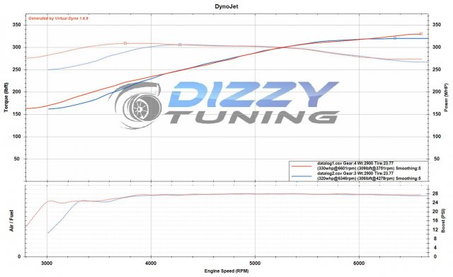

Yes, I have started playing with E40. I was able to get my first logs for review the other day, but haven't had a chance to play with the tune any more.
This week I plan on testing boost levels up to 32 psi. I will also be getting on the dyno soon for some real numbers.
My man! Let's us know when you notice the turbo getting spun out of its efficiency range. As you know I am aiming for around 32psi on ethanol :), let's hope she has some legs.

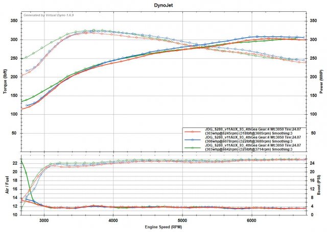

Final 91 Octane Pump Gas Tune
Raw Virtual Dyno, No Dyno Jet 1.09 multiplier, no DA adjustments
DA was the following:
DynoJet # with no DA corrections: 305whp, 281 lb-ft
VirtualDyno # with DA correction: 308whp, 283 lb-ft
DynoJet # with DA correction: 335whp, 309 lb-ft
Datalog Link: https://datazap.me/u/jdub1990/s280-final-91-octane-aux-fuel-da-4627ft?log=0&data=5-6-9
On to ethanol...

I know they are different revisions, but look at the powerband for the aux fuel 93 vs e40. Torque comes on around 3000rpm on e40. 3500-4000rpm for 93. Powerband would be similar without aux fuel. Overall top end up would be same or slightly lower go numbers without aux fuel for e blends but a stronger low and mid range powerband and faster spool.
It's not just about peak numbers. But if e isn't readily available around you ...,[emoji2376]
