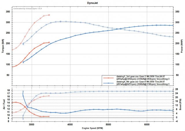

So I filled up with my first tank of E85 in the fiesta today. The base tune is dumping wayyy too much fuel right now so I couldn't get past 3,500 RPM but check out what the torque is doing! I have a 93 octane log posted up next to it for comparison purposes. 335 WTQ at 3,400 RPM in 3rd gear!
This thing is going to rip here pretty soon:
EDIT: I think this was wheel spin after subsequent logs.

How's the spool up on the s280? It's a huge contender in my book for turbos. Actually it's higher on my list then whoosh two hybrids. Big concern for me is I want close to stock spool.
wetwea33
#8616
634
494
Look at the vdynos you can see the spool for yourself...

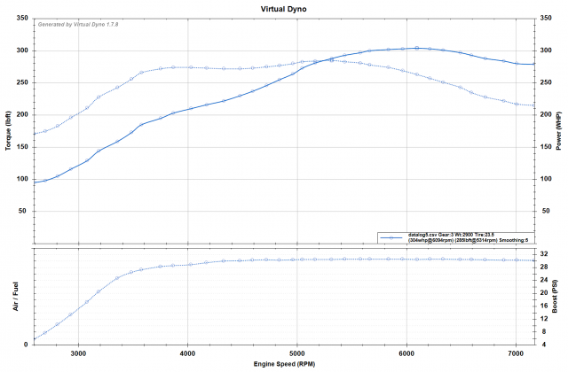

#10197
61
68
Revision D of E30 (only 11 degrees of timing @ 6k rpm)
Raw Virtual Dyno, No Dyno Jet 1.09 multiplier, no DA adjustments
DA was the following:
DynoJet # with no DA corrections: 331whp, 310 lb-ft
DynoJet # with DA correction: 368 whp, 345 lb-ft
VirtualDyno # with DA correction: 338 whp, 317 lb-ft [most accurate imo]
Datalog Link: https://datazap.me/u/jdub1990/s280-middle-tuning-e30-octane-da-5000-ft-tucson-az?log=0&data=6-9 &data=5-6-9
Cant wait to see some real timing :)
