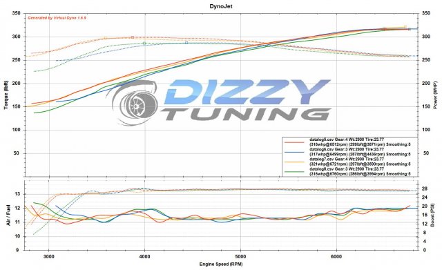

From my FB page:
"It appears I may have reached the limit of the OEM clutch. Keep in mind, my Fiesta ST has 52K on the clock, but as I push its limits more and more every day, I think it finally gave in.
I recently addressed some boost leaks that were discovered as boost pressure was increased near 29 psi. I fixed those, and took the data logs that are in the attached VD. The clutch held consistently at this power level and didn't skip a beat. But when boost pressure was raised slightly over this, the clutch started slipping.
I may go with a reverse boost taper, which is something commonly done in the Mazdaspeed platform. Keep boost tame near spool up (to control the slip), and then give it hell as RPM's increase. I may give this a shot, but at the end of the day, I need to replace the clutch.
Drop your suggestions on a replacement in the comments! I'd love to hear your experiences and impressions of overall drivability and feel for a somewhat-daily driver."

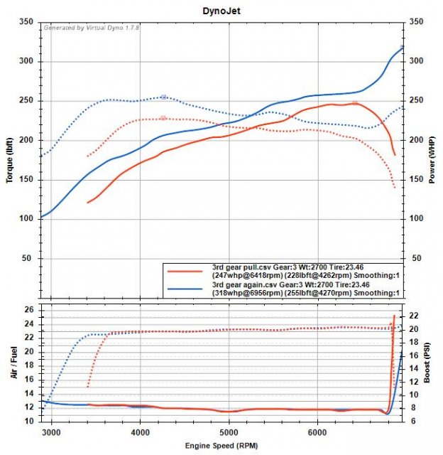

here is my base map 3rd gear pull, there are 2 pulls on it.

How do you do that? Newb sorry!!
You just have to go into the datalog excel sheet and delete the cells after you hit the Rev limiter. Look for where is set and look for where your airflow starts going down. Delete those cells and save it.
awesome I’m. Got it!!

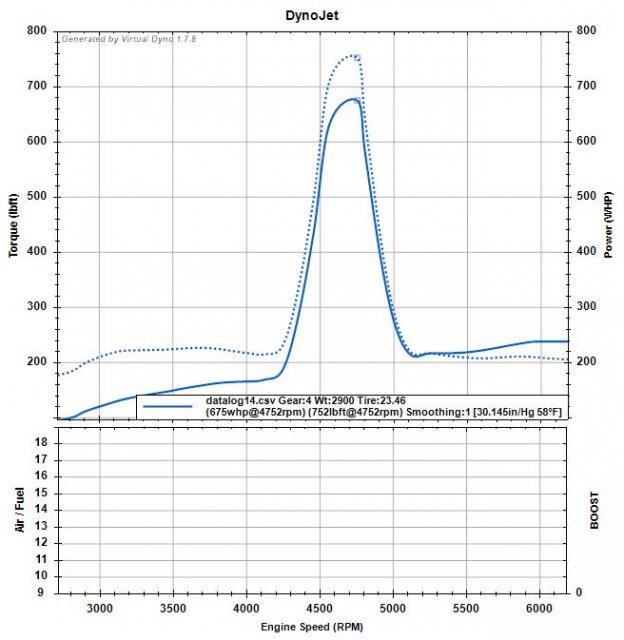

I did a 4th gear pull but when I put it in the vdyno it came out really weird. Can anyone explain this to me?? messed up vdyno.jpg

Look at the log and see if it looks normal. Might have been currpted transferring to your computer.

yeah it was. I asked my tuner about it and he said the RPM spiked momentarily in the log so that is what caused it.
