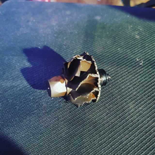

Well we have a 2J side exit on the car. It was conveniently sitting where an extendable magnet could pull it out, but I only found that out after I dropped the middle section lol.
Is this from the turbo failure reported about last week? Or is this a new “issue”. Either way, good god…
