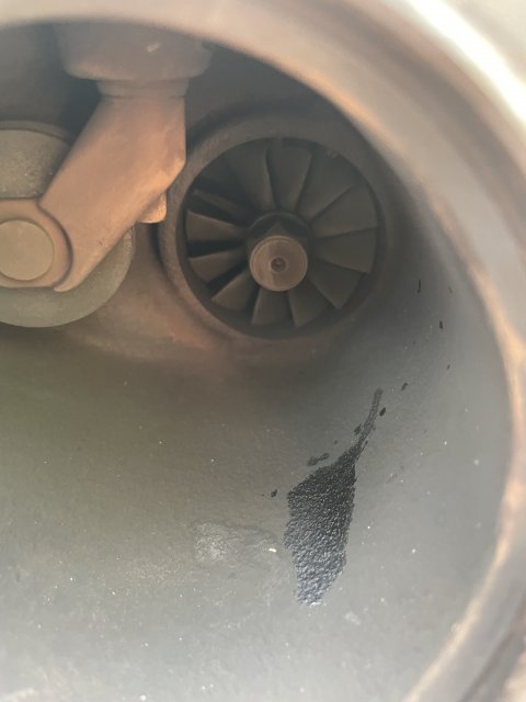

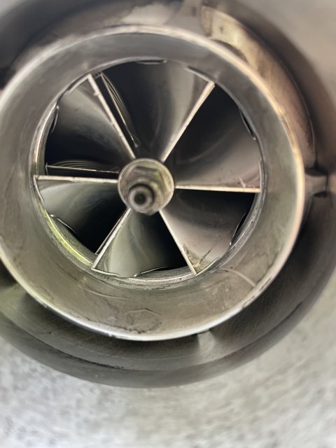

as promised, failure #2. This one isn't as bad as the one from our race car, but I feel under the right conditions it could have been. Major shaft play and the turbine wheels on both sides are damaged. The housings on both sides are also damaged. We are most likely going to send this one back to TT as well, but I don't think the owner wants to rebuild it or do anything with it at all. Also this unit retained the stock WGA, I thought he had put a Turbosmart on but I was incorrect.
Geez you’re a turbo killer haha. Is this the one that was newly installed?
I wasn't even near the car this time! Lol. No this belongs to a friend of mine, we haven't received the replacement turbo yet. We had originally planned on buying this one as well but then it let go.

What kind of boost were these turbos pushing? Any idea what actually caused either failure? Was it just the turbo giving up?
26~28psi ish I believe. No idea what caused either yet. Waiting to send them back and get solid info. The first one should be headed back soon, the second one I am not sure if it will ever go back.
