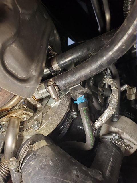

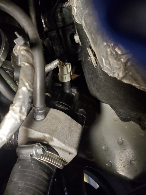

Also, just to make sure. The boost solenoid, the side with the plug goes to the turbo, middle goes to the wastegate, hose opposite the plug goes to the bov. That's how mine is set up. That's how I saw it in the installation videos.
2,621
3,069
Burlington, NC, USA
The hose opposite the plug, that goes to the bov, correct? The picture doesn't show a bov, so now you have me wondering. Actually the block that holds the bov, not actually going into the bov.
Correct, that’s your compressor reference. Sounds like you’ve got it right.
