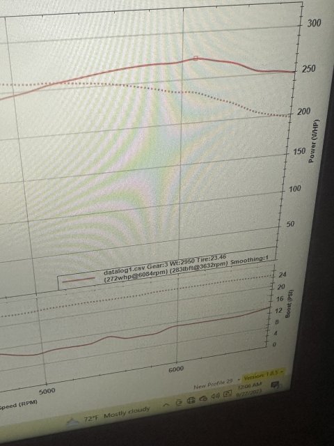

Definitely loving this turbo. I don’t get crazy wheel spin in second and it gets decent traction with the current tires I have on. I’m in my second revision with Adam on 91 and this is where it’s at. I think it’s about time to wrap up 91 and couldn’t be happier. Completely left a FRS in the dust earlier after he tried to play with me lol. I was just cruising and he wanted the beans lol

Finalized my tuning with Jason, he's saying I'm making a good 50whp over stock. While I'm fairly happy with that number, on first glance 200-220whp (depending on measuring variables) on 92 feels a little low. Not that I distrust his judgement, but more just trying to figure out my own expectations. I know inevitably I'll want to upgrade something again and I only try to make changes with proven gains since anything else is a waste of money unless it makes me feel good, and he indicated that switching from stock intake wouldn't do me much. Which was a surprise seeing other people's experiences, but if it's good enough then it's good enough.
This only came up because now I'm sort of through the honeymoon phase and I'm doubting myself having put in all this effort for something that the butt dyno doesn't feel like it's faster (in spite of knowing it is objectively faster). I don't know. I don't regret it, but I think my expectations were set too high even compared to other people on pump gas. I can pick up E85/race fuel/whatever but it's not common at the pumps here so I'll be paying $$$ if I want it for the track.
Ultimately I'll come to terms with it regardless, but I don't want to leave easy power on the table if I can lmao
E85 is overall the best bang for buck even on stock hardware. I agree with you, the gains after that aren't that great on the stock turbo. I upgraded the intercooler and crossover pipe and lost some torque and gained a little HP. I don't plan on doing anything else unless it's a turbo at this point.

Ya his numbers sound real low for an S280 even by Dizzy’s own upgrade charts.
Full disclosure, I'm still on the stock airbox. ST200 or an ITG/Peron are on the list (along with crossover piping) but I'm a little surprised it's apparently so heavily choked up by the stock box. Hence the initial surprise to the misunderstanding about the intake.
Wish I made that much. 😪 235 whp on a mustang dyno, 255 est. whp for a dynojet on 91 tune. My 93 feels stronger but haven't dynoed it yet. Good numbers

Airbox will not make that big of difference only difference is It Is shorter and sucks in cold air through the bottom . A larger crossover pipe will help but again not huge gains . Your numbers still sound really low unless you dynoed on a Mustang dyno.
235 on a Mustang dyno is 275-280 on a dynojet. I dyno’d at that on a Mustang dyno as well witH my first tuner and the car was fast but tossed tons of codes and some that the tUner wanted to blame on Cobb so I bailed and went to Tune+ never looked back that was like over 2 years ago v dynoed at 284 whp on 91 and 284 ft lbs . Oh and yes the car is faster than it was on the first tuner.
