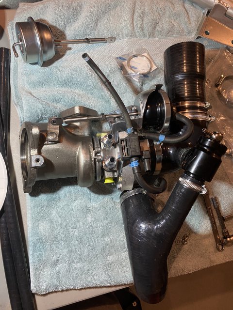

Can anyone with an S280 confirm if I have these lines routed correctly? I believe the disconnected solenoid line is supposed to be left disconnected, is that right? Also I'm confused about where the BOV is supposed to be connected...
Related, I understand the Turbosmart 14psi wastegate is supposed to have 2mm of preload and the instructions say to use compressed air to install. I've got the lever arm about 2mm from sitting on the actuator arm, so I'm supposed to run compressed air in through the vent line in order to actuate enough to slip over the linkage, is that right?
Please help me, I'm dumb! View attachment 59437
Not dumb. That’s routed correctly. You can leave the other end of the solenoid open to atmosphere if you want, or you can use a quick tap and route that air back into the intake elbow. The BPV should have come with a boost reference source that goes on the intake manifold’s MAP sensor. You route the vac line from there down behind the engine to the BPV. Make sure you don’t route it somewhere that’ll touch hot exhaust manifold.
Thank you very very much!

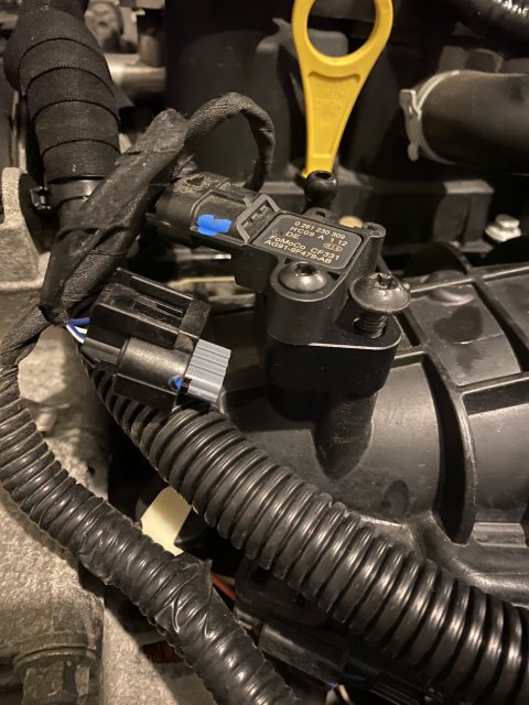

I was able to figure out how the BOV routes to the MAP sensor. Now I just need to sort out how to preload a wastegate and I think we'll be ready to install.
