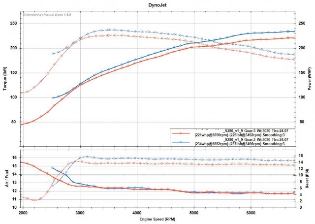

Why after a revision is it still less than en e30 tune on the stock turbo?
I'm assuming that not too many tuners have done tunes for the S280, so there isn't too much experience to reference as to how much to tweek at a time? I figure that a very conservative base tune and small increases are required until they see how this turbo responds to changes.
Plus look at the boost. It's only at around 15 psi. Probably got another 12 to 13 more lbs of boost left to go.

Most people aren't making that on a stock turbo and on e30 on a stock turbo you would be 27-29psi. I'm on my 13th revision on 93 for this turbo...
Ah, I was under the impression that e30 was ~220 whp and ~280 wtorques
I’m sure the S280 can push much higher and also closer to redline.

It varies from car to car. This is also vdyno and it's only accurateish if it's setup properly and you know ur cars weight.

As stated before, the S280 isn’t useable on e30 without aux. I’m making 285whp in 50* weather. I make about 270 in 80*+

Mitch just finished up mine so he’s done at least mine haha. But he takes his time, does a really great job.

I should have clarified - e30 on the stock turbo.
The 285whp you just posted seems more like I would have expected from the S280
I suspect, as others have mentioned, that this tune is still just a cautious work in progress.
