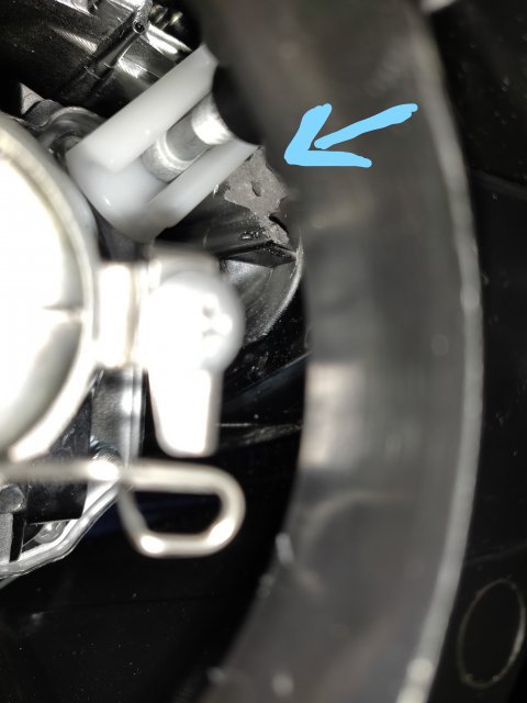

They arrived today! BUUUUT broken adjuster on the right side. The top adjuster is snapped off clean and the entire assembly wobbles like crazy. I've sent an email to cars245 with following pic. I responded to the order status email as well as the email address they use in PayPal. If they don't get back to me within 2 days I'm escalating with PayPal.Wish me luck. :mad: I'll report back...
Sucks they came in damaged. I wonder if they'll have a replacement on hand.

Glad to see yours arrived safely! I'm still working with them to resolve my broken one. They've been responsive so I'm optimistic.

They offered me a 20% credit to shut up and drive. I asked them if that was 20% of the whole order or just the one headlight. One response per day so i won't hear back until Monday. If it's the whole order, i may take it. That would cover half of the cost of ordering a replacement.

1. I haggled with Cars245 and got 26% of my order credited - $92 - i used it to order the replacement which arrived in perfect condition in 3 days. I am no longer using a zip ties to hold my passenger headlight quasi aligned. Now to find a good article on proper headlight alignment techniques. I would still say it was a so-so experience with Cars245. The order of events was...They offered 20%. I countered at 35%. They credited 26% without my approval and stopped communicating. At least i got something back. I plan to crack open the busted unit and glue the adjuster back on.
