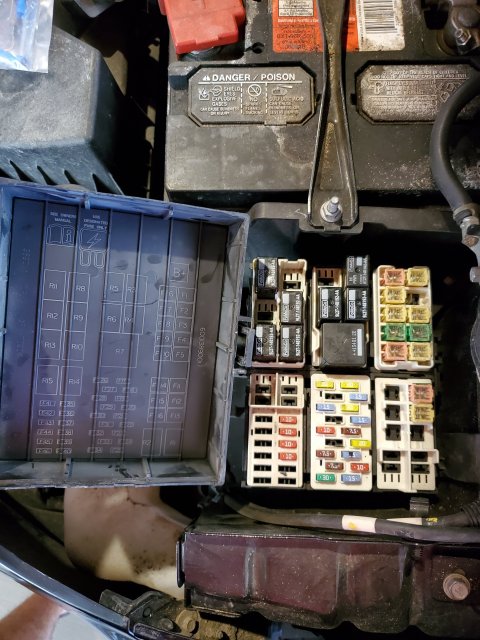

Well, did it again except, did the normal routine of shutting off the engine before opening the door. There has to be some logic to it, but for the time being it is seemingly random.
EDIT 20y05m17d:
While the entire row of F22 through F26 is switched with ignition the majority of the time, the remaining Micro2 fuses and empty slots, (27-31, 38-42, 7-11) are not switched with ignition. They seem to be hot at all times, or blank.
Seems random to me too... but for some reason happens the most when using auto lights and in the morning when when transitioning from night light to daytime... usually 2 minutes and they shut off but certainly doesn’t happen every day every time. Since no many people have this issue could be something we did wrong on the wiring process ?
I feel bad this is happening to you, so I went and took a look to verify the wiring and yeah, confirmed the moved wire goes into the bottom right spot and the added power to the pin right above it and ran off F26 where 2 wires, one to each pf those top right pin on each side, meet at the end of the add a circuit tail... I wonder if this is something to do with the tune at all, not sure if you have an AP, but I change my tune frequently between 93 and e50 so maybe when the tune gets flashed and a lot of stuff gets reset it detects those new connections? I'm just trying to brainstorm to come with ideas for you since I've never seen mine stay on for more than 30 secs at the absolute most, but it may have stayed on longer before I had reflashed after the lights were initially installed... hmmm.

With regard to drivetrain and programming, I'm all stock fellas. Coolant pump and active grill shutters, are things that I can see being powered on for a period after ignition off, probably dependent upon engine temperature. Engine temp can be read from diagnostic mode. (https://www.fiestastforum.com/threa...ould-secret-features-thread.15615/post-406280) Of course, it'd be up to those modules as to whether to actually do anything with that power. These are things that would be on the 1.0L GTDI model.

OK, confirmed mine does this too! Yes, I use Auto lights and they had just come on driving into my garage before turning off the car and getting out, but doesn't happen all the time. So for now, until we find another fix, If you ever get out and notice they are still on high, then go back, open the door and reach in and cycle the ignition back on for a few secs then off again. Then, when you close your door they will then be dim and go off in like 5 secs... Since I just noticed this parking in my own garage and don't lock the door, perhaps locking the door, and/or cycling the lock a couple of times from the key fob might work too.

Hi everyone, thanks for all the write ups! Currently waiting on Hellas from cars245. I am sick of the oem lighting!
I did have one questions and wanted to make sure im interpreting this right....
For the '14 FiSt when adding a circuit it was mentioned to piggyback F20, so would that mean i pull out the 15A fuse, place the add a circuit in that spot and replace the 15A fuse onto add a circuit? Or is it still a 5A fuse?
4,131
2,674
@deegs28 - The "Add A Circuit" type products aren't designed correctly... or at least not with the proper package label warnings. If the original fuse was 15A and you install a 5A fuse along with the 15A, you're potentially placing 20A on that wire. If you look at the exposed wire bundles beneath the box, you'll see that you have varying degrees of thickness... different wire gauges. Copper is expensive so manufacturers wire mostly for what's necessary in that line of vehicle. The danger is, over a period of years the wire may get warm enough to gradually melt through its insulation, then begin working on adjacent wires. If a short ever occurs, it would be HELL to troubleshoot, let alone find. If they had designed it right, the 5A would slave off the 15A, meaning there would still only be a maximum potential of 15A going out over that wire.
If you cannot locate an empty spot that is switched with ignition, my advice would be to install a relay.

Wow... I didnt even think of that, that makes complete sense embarrassing engineering moment here!! I guess I just assumed that is how they worked. (https://www.fiestastforum.com/threads/what-should-i-do-about-lights.21319/page-6 ) Don't know how I missed this forum but saw you mentioned it here too, definitely something to consider to do the install correctly..
Ive never added a relay to a car before total noob haha, but would this mean that I would have to add a switch in the cabin to run the LED strip on/off? It seems like connections for a relay are made outside the fuse box and I would need a way to control it if I am not able to find an open fuse that runs with ignition with the micro2.
