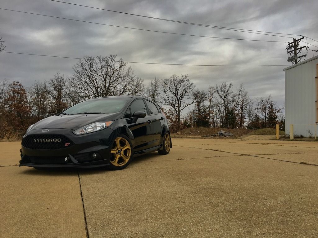

Loving the shaved grille. I've given up on waiting for decent weather so that I could wash the car.
14,906
7,354
#43
^^^It (the shaved grille) actually does something for your IC/radiator cooling with the DHM crash bar in place (vs. the totally blocking factory crash bar).
masonsturbos
597
114
saint louis
#44
It does actually open up about an extra inch or 1.5 before the crashbar...
