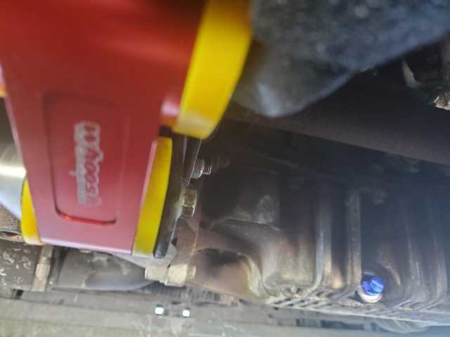

Finally installed a pierce motorsports chassis brace. Now I see what all the fuss is about. It greatly decreases torque steer which is still surprising to me. Turn in response also appear to be much quicker.
Now to figure out how to get the skid plate to clear it..

^^^Yeah, that's probably gonna take a HUGE stack of washers used as spacers, or a really big block of aluminum drilled through, and MUCH longer bolts, to clear that one, why I won't even chance the much flatter Mountune one, if I could even find one now that they've dropped it from their catalog. [:(]
I guess you could just weld tall threaded blocks onto the cross member?
The rear mounting points need to be spaced somewhere between 3/4"-1.5". It's really not as bad as you say. I may also try bending the skid a little bit.
