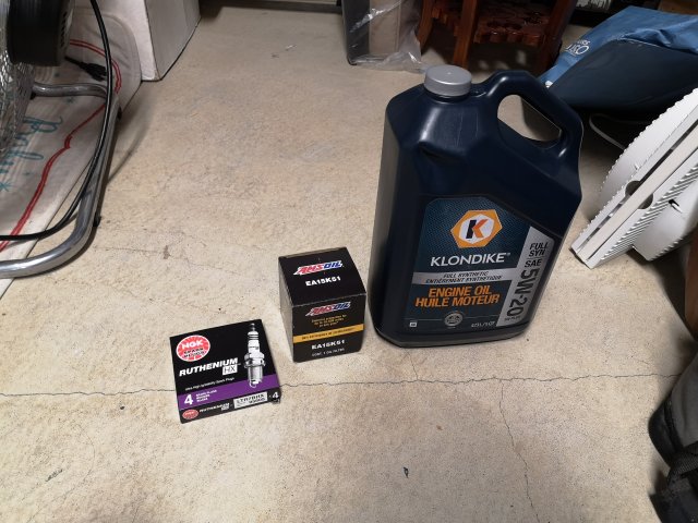

I did sort of an early tune up for winter. Still too early to change to winters so I didn't do that yet. I did new Ruthenium plugs, very nice amsoil oil filter, and some cheap local Canadian synthetic oil that I'm a bit apprehensive about trying.

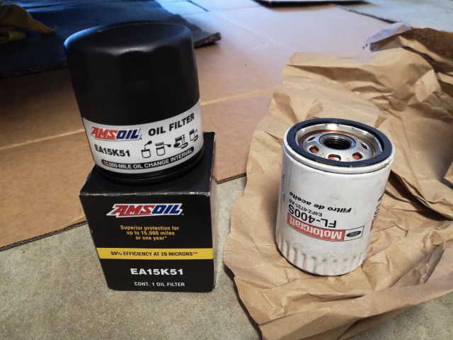

The Amsoil EaO34 is the equivalent size to the FL-400S Motorcraft, but yeah, it's even a little bit longer than the 400. [wink]

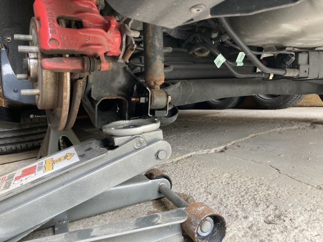

Had planned on swapping out my rear shocks with some Bilstein B6s, but got stuck removing the lower bolts. Time to go impact wrench shopping.
The session wasn't a total loss, I rotated the tires and replaced my rusty amazon lug nuts with a set of McGards.

Ya I saw that and I even asked the local amsoil dealer if he had it but he didn't. He just stocks the ea15k51 oil filters because he uses them himself on his miata. I'd been using the fl400s on every previous oil change but i did a little research and found out that this amsoil filter has one of the best ratings at 99% efficiency at 20 microns. The FL400S is 80% at 20 microns, which isn't bad at all and is actually pretty good but I just like the peace of mind of having cleaner oil in my car. Also, I'm new to amsoil and I'm going to be trying out the amsoil 5w20 oe series on my next oil change.

Yes, I also use either the Amsoil EaO34, or the Fram ULTRA 3600 (their best, top of the line filter which is about the same filtration level as the Amsoil EaOs), but the Fram is even a bit longer yet than the 34, so yeah, it is like an 1/8" away from the fan shroud.
IF you plan on using a lot of Amsoil product, it would pay to become a Preferred Customer for the small fee they charge in order to get a decent discount.
I would personally use their SIGNATURE SERIES oils, either 5W-20 or 5W-30 (or possibly even the 0W-20 for the winter OCI).

Besides from having a higher total base number and lower NOACK Volatility, the specs seem pretty similar. Besides from that are there other reasons why you would suggest the signature series? I like to change my oil often but if I do get the signature series, I'd probably do a 1 year oci.

Yes, if you are going to change it often (like at the 3K miles which most seem to consider very wasteful, even for much lesser oils than we are discussing) then the OE series would be fine, but then most of the synthetics on the shelf at Wal Mart, or whichever equivalent stores you have near you in the great Northwest, are also just fine, and of a similar NOACK number, TBN, and base stock/additive pack composition.
For me (but yes, admittedly, I AM most definitely 'overkill OCD' about this stuff!), I just like the much higher PAO base stock content, and better additive pack (besides the significantly lower volatility due to the base stock's high PAO content, which helps repel/lessen LSPI in TDI engines) of their Sig Series. [wink]

The oe series is tested to prevent 100% of lspi as is the signature series. Not to mention the new api SP and gf 6a formulations that are out now, all the synthetics will probably work good. I guess it just comes to personal preference. I do like the low volatility of the signature series though.
