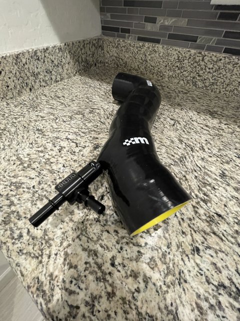

More recently, I decided that I might as well upgrade all of the induction and intercooler piping, so I ordered a Mountune Induction Hose so the evap harness is plug and play.

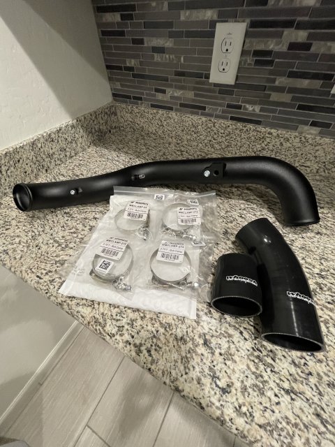

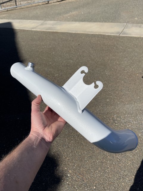

I also picked up this awesome "Cosmic White" Crossover Pipe from @ron@whoosh! It doesn't quite match my White Platinum Metallic paint but looks great installed! It's got a cool flake in the paint as you can see in the daylight! [twothumb]
Also picked up the Whoosh Cold Side Intercooler Pipe just to complete the loop of piping! Grabbed a couple extra oil filters as well to stick on my garage shelf since I have a lot of road trips coming up! :)

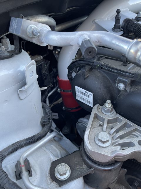

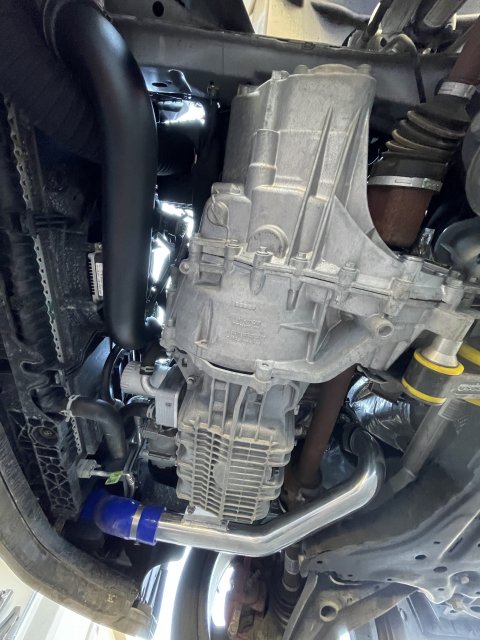

While I had some time today, I decided to install the Induction Hose, Crossover Pipe, as well as the Hot and Cold side intercooler pipes and hoses.
The windshield wipers and cowl definitely don't have to be removed in order to install the Crossover Pipe and Induction Hose. The easiest way that I found was to remove the passenger side headlight, carefully move the coolant resevoir out of the way(leaving hoses attached), and you've got plenty of access to get to the hose clamps with a 1/4in ratchet and 7 or 8mm socket.
I was even able to sneak the Crossover Pipe in there with the Induction hose already attached to it. This setup compliments my ST200 Airbox perfectly and still looks pretty subtle! ;)(y) (Excuse the dirty engine bay, that's a project for soon!)
While I was installing the Cold Side Pipe, I noticed a long deceased mouse that was lodged between my radiator and fan shroud. I checked all wiring all over the engine to make sure this little sucker didn't chew on anything important, and luckily found no damage. That's it's head and whiskers in the right side of this pic. Rest in pieces little guy. :rolleyes: IMG_8790.jpeg
Hot and Cold side pipes installed. I've gotta say, I'm impressed with the ease of fitment and clearance of these Whoosh pipes, great quality from Ron! [twothumb]
Took the car for a drive after installing everything and it feels great! Difficult to say if there were actually any gains, but it pulls just as hard as it ever has! Now I feel like the car is ready for a Whoosh Hybrid Turbo when the time is right. [driving]

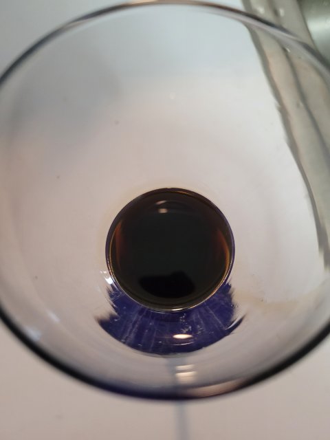

Oil change. First time emptying the catch can. About 1000 miles. I like to put it away with fresh oil for the winter. With any luck will be getting fresh 5w30 with the hybrid install this spring. (If the world is still here)
Used the wine glass to show what came out of catch can.

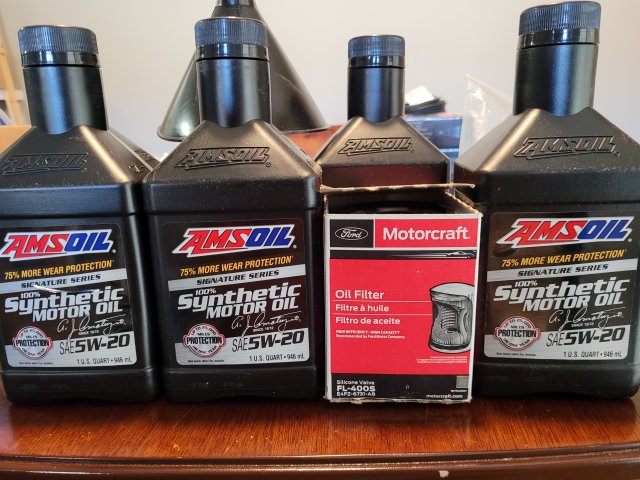

Put the oem wheels back on. Grabbed some oil for the daily and for the turbo install. Will probably be a lot more expensive by then. Figured I would do the penzoil for the break in period then switch back to my amsoil.
