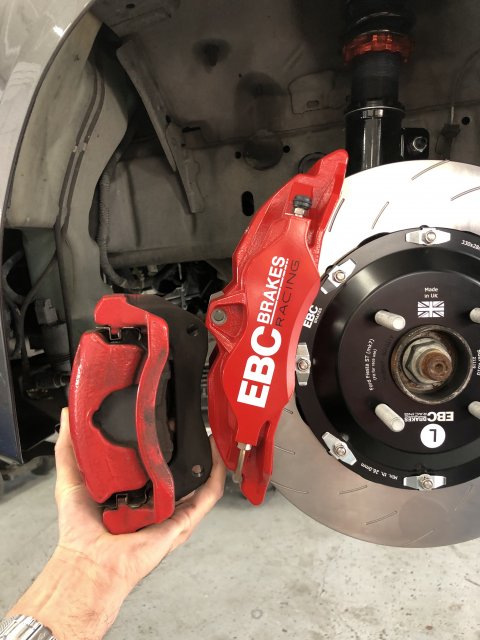

What size spacers and where did you buy them? Still gonna roll the stock veels?
Hey T,
I got 15MM spacers from Whoosh Motorsports. They're the H&R Spacers with the Extended Studs. I'm not 100% sure they'll fit and am at the mechanics shop now. But someone on YouTube I asked told me they ran 15MM spacer with the OEM wheels so I'm hoping they actually fit. Since the car just got lowered 1 inch it was worth a shot. Mostly because the car will have to get raised if they don't work on them and I took the risk. Will update in an hour or 2 once they're done so I can let everyone know if it will work.

The calipers barely didn’t clear. Just touched by a hair. Literally. Going to get some custom 18MM spacers and that should have it dialed in perfectly. But I’ll update everyone once I get to that point. The 20MM would def work with a bit of wiggle room. FYI.
I’m the meantime the mechanic ordered some spacers locally in the meantime while I wait for the custom ones.

So what's the verdict? Did they work with the 15mm spacer? With stock veels? And being lowered?
No it's going to need an 18MM spacer. It will fit with a 20MM but for my application, I'm getting a spacer made.
The 18MM is going to probably cause some rubbing though. We're not 100% sure yet. We're going to try this Friday and see how it goes. Since I've got the car lowered about 1 inch I want the minimum spacer needed to prevent that.
