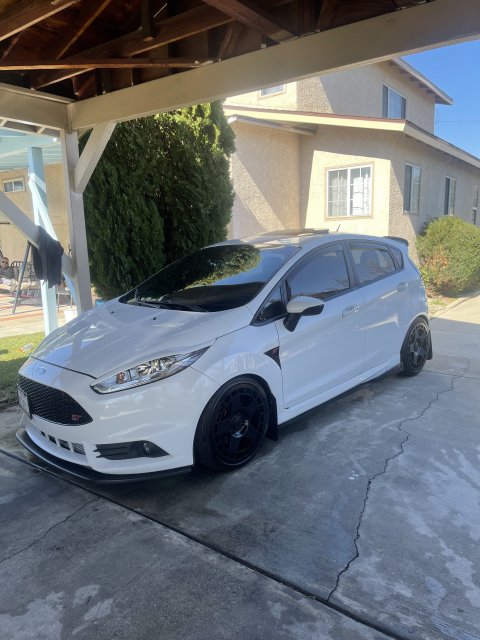

you ever accidentally kick your feet on those fins? lol
Gas prices are down, so that means back to E30
Nope ....surprisingly not* but I have dragged them on steep inclines before. It is also lowered on Swift Type Rs. I just have to be a good judge of inclines at some spots....just part of life now I guess.

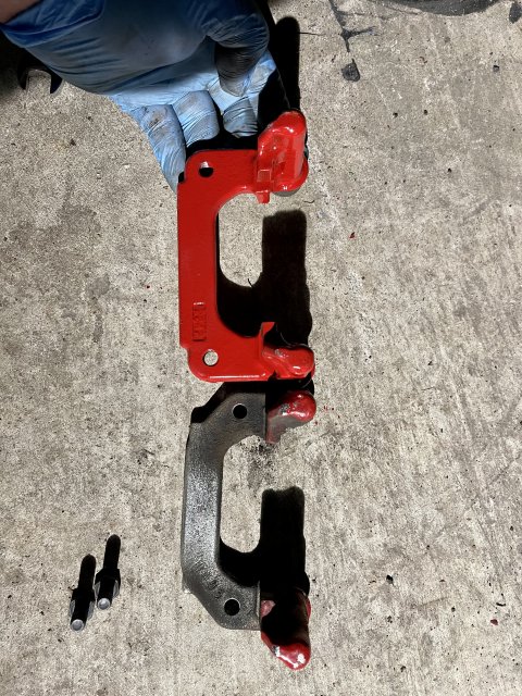

Finished up my Wilwood front & SVT bracket rear brake upgrades tonight! All that is left is to bleed the brakes and give everything a thorough once over tomorrow.
Pro tip for anyone considering Wilwoods, blue painters tape is your friend to hold the shims in place between the bracket and caliper. I probably picked those damn things up off the ground a dozen times or more before I taped them in place. Even then they still tried to shift around and out of alignment.
