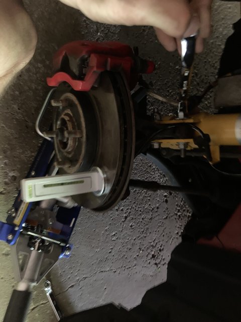

We’ll, front left had a few turns and I’m guessing wasn’t fully seated.couldn’t get my torque wrench to hit 55 front, but got as tight as I could without breaking my Allen key or the socket falling off. Coincidentally this was the side that made the most noise, here’s hoping it’s good enough.

What if the Hub is rusty....wouldn't that offset readings?
It’s rough anyways. If it’s relative than the displacement is fine. If it moves 1 deg it moved 1 deg. You just need to know your starting point.

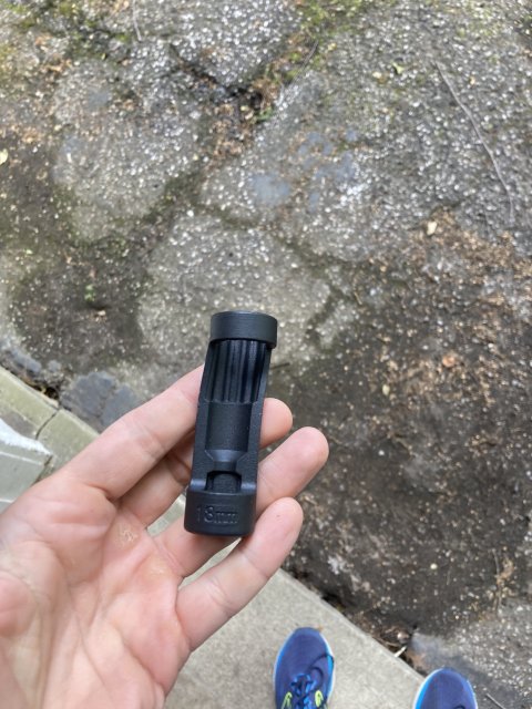

Also whoever decided to hex the strut shaft can fuck off. I refuse to believe there isn’t a better way to tighten the bolt to the shaft. Started stripping the passenger shaft.

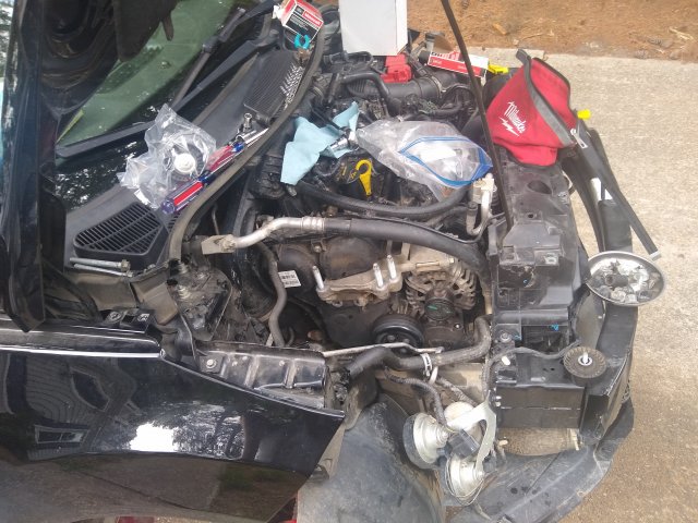

On vacation so gonna utilize this time to put back my parts I took for for smog. Includes a new Milltek downpipe, whoosh boost hoses, going back to my kompact shorty over the VeePort for now and some other small stuff should be fun. Not looking forward to the downpipe tho lol even though it does get easier the more you do it
