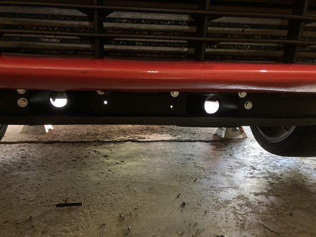

Got the Eibach front swaybar done with Whoosh SS lines plus a clutch/brake bleed. Took the car to the track right after. Needs an alignment but she handles like a go kart as is. Swaybar is definitely worth it.
Makes sense your car came with the smaller front swaybar. One reason I like my 2018 it came with the larger front stock.

Curious: doing the trac bar on jack stands, were you able to tighten the control arm bolts per spec? If I remember right it was a torque spec (like 90 ft-lb or something) then 180 deg. I have an 18” 1/2” drive breaker bar and got maybe 90 deg rotation. I’m not worried about it really. But curious how you fared.
Basically got the same - torque plus 90 degrees or until the end of the handle hit the floor. No problems. I even checked the bolts a couple weeks ago when it was back up for my intercooler install and still all good.

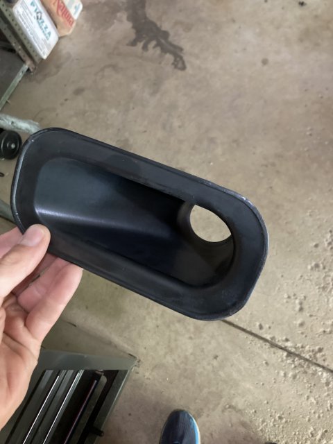

The symposer was a huge pain in the ass to remove. Was working in the parking lot and had a neighbor randomly come out and provide some much needed extra hands and help. I liked the symposer noise but sort of hated the ear fatigue and competing frequencies in the 2800-3300 RPM range. Totally cleaned that up but you do loose that little bit of growl. Overall worth it.

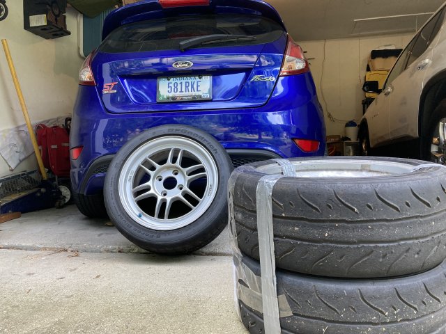

Found these waiting for me when I got back from taking the kids up north. Can’t believe I get to drive wheels and tires like this - it’s a dream. Enkei’s with (used but usable) RT660s. Got them all for $700.
Can’t wait to try them out at the next autox - so long all seasons and heavy wheels! B600D1AF-30EA-461F-86D7-11170DCB3108.jpeg

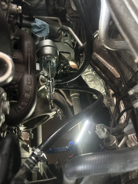

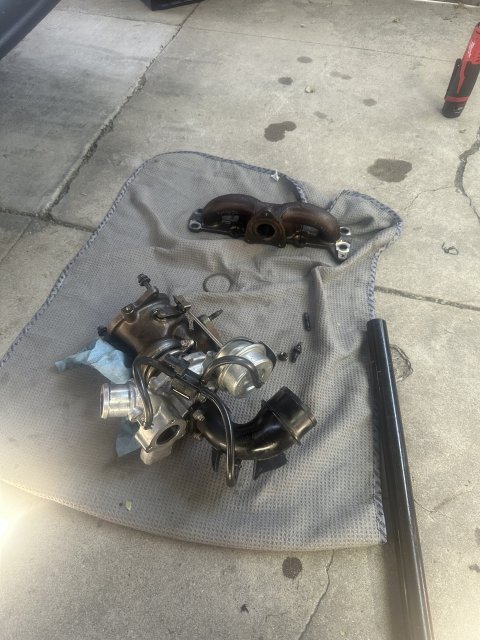

Got the old turbo off with no complications. S280 going in Sunday!
Did you drain out coolant or just disconnect coolant lines and deal with what came out? I'm planning to just shift the reservoir and take the lines off without dropping all the coolant
I shift the reservoir and jam a rubber stopper in the line before too much coolant drains out. Oil is harder to stop, but not much oil comes out anyways. If you disconnect the oil drain from the turbo and the oil feed from the engine and just let it sit for 10-15 min with a drip pan, you’ll get the turbo mostly emptied as to not drip oil on your face or the valve cover depending which direction you go.

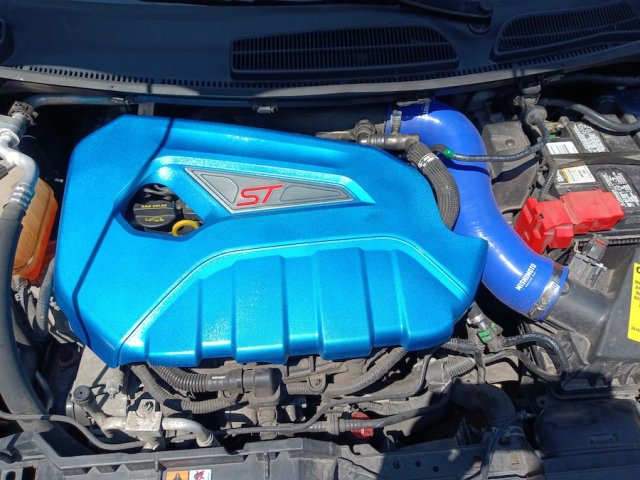

Painted the engine cover using Metalcast Automotive Spray Paint. From a distance you can't see the minor flaws. I had it in a box during painting, but the wind still got a few small particles on there. I should have done it in an empty garage with the door closed.
