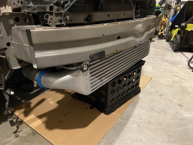

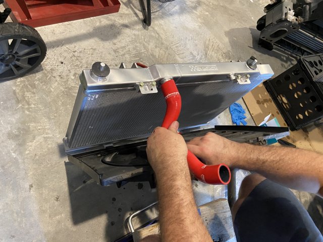

Not today but over the weekend installed a Koyorad radiator, Whoosh radiator hoses, Whoosh V3 FMIC, AWR RMM, and a new belt and tensioner (getting close to 60k miles, figured I’d get it done while the coolant was drained). I have a Radium catch-can but I’m waiting till next couple days off to install it. I also uploaded the Cobb stage 2 93 tune which is sufficient. (For now).
The AWR RMM is amazing and the difference in shift feel, feedback, and firmness is night and day from stock. I live in Houston and with the Koyorad I was seeing 170-180 degrees moving, 180-190 idling with the AC on. Great product. The intercooler was great too, a tad heavier but fit just right. I probably should have installed a Mishi/Motorcraft thermostat but my friend who had a FoST expressed concerns regarding undercooling so I decided against it (for now). The only thing I regret (and would recommend) is to line up the washer marks on the crash beam when reinstalling. Mine was a tad lower and it caused very minute, almost not visible fitment changes along the bumper/fender seam.

Did you take off the front crashbar for radiator or slide it in from bottom? Curious as this may be something I do as well.
I took it off, I was doing quite a bit and the bumper was coming off for the FMIC install so it made sense. I also didn’t have a lift and limited space so it was imo the better choice. Getting hoses on and off (if you’re changing those too) isn’t hard but having that extra space made a difference.
