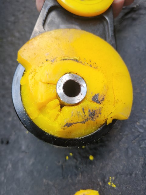

Poly had turned to powder in some areas. Only the rear larger bushing was degraded. The front smaller one was fine. This has 4 yrs and about 8000 miles on it.
I liked the poly feel better (before it failed) compared to the vibratechnics so far. Thr vibra technics has a bit more nvh. When under 40 degrees the poly has more nvh until it warms up. I do only have like 5 miles on the vibra technics so it may settle in some.

Depends on the Durometer of the urethane* and the Manufacturer. The Vibra is epdm rubber and will last longer. i really liked the Vibra but wanted to try AWR 70 durometer and new mounts with my setup.

and soon it won't be A/C season ( I may have turned it on once this year), so NVH will cure itself! On Vibra Technics and love them - the polys wear fast..

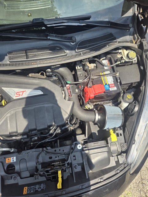

Installed the 2014-2015 Evap harness and a whoosh intake tube on my 2016. I got almost a third of the way through removing the bumper to install the velossa tech big mouth and decided I wasn’t up for that today. I think it’ll be much easier after removing the front wheels. I’ll try again another day. Just got too frustrated reaching those bolts at the fenders and had an insanely rough time unplugging the headlights of all things.

was the damage visible from the bottom of the vehicle?
