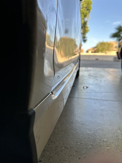

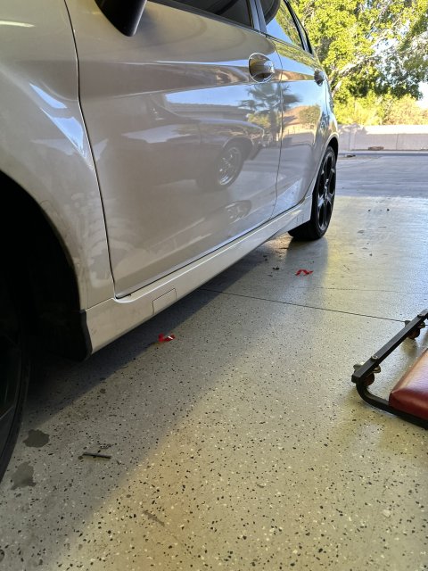

yesterday i replaced clips and 3m adhesive on my left side skirt. it was a solid 3hr undertaking because i couldnt figure out how to put it back ON. i eventually got it and the fitment is MINTish.
EDIT: the black you see right above the side skirt in the 2nd picture is actually something to do with the PPF... not planning to pull any of it off, though. just wanted to be clear about the fact that it is NOT part of the 3M adhesive - I made that very well hidden & flush.

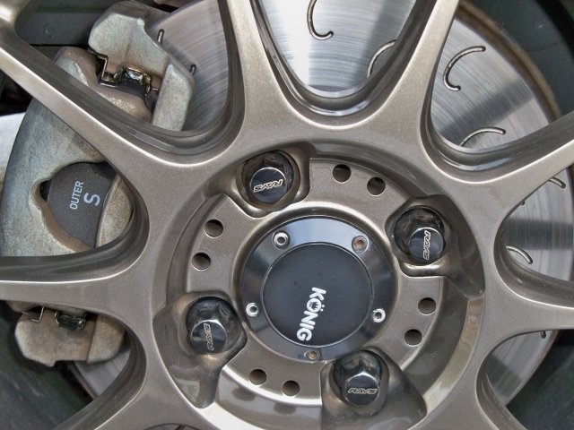

FINALLY got the brakes done (after 8 years of ownership and almost 50K miles!), along with a full flush of the brake system and clutch system.
Whoosh 'J hook' slot rotors front and rear, along with Motorcraft factory 'S' pads, and all new hardware (retainer clips, boots, slider pins, mounting bolts).
Goodridge stainless braided brake lines (bought from Ron at Whoosh), and Bosch DOT4 LV brake fluid (highest wet and dry boiling points available in any DOT 4 LV type fluid on the market).
Big thanks to Otis @Next Level Auto in Plainfield, N.J. for the great labor at less than a third of what a dealer would charge for the same, IF you could even find one (or even a private shop) willing to use your supplied parts.
He even wire wheels the rust/crud off of the hub faces/lugs in order to avoid any run out problems, just like in the Royal Auto brake video on you tube.
I am pretty sure that the dealers do NOT do that extra step, and if requested, they would tack on another $150.00 onto the bill for the extra 20 minutes work.
