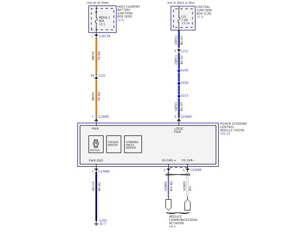

Since you did work on an axel and you are getting a steering error, please check these connections.
