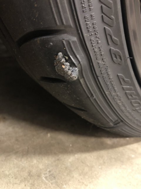

Went for an impromptu mountain run to scrub in a new set of 615s and shit! Jigsaw blade slice. It took a big bottle of slime and two large plugs with rubber cement to get me 50 miles home. Worked like a charm lol. No. No I didn’t have a spare nor a jack or wrench. But I had a buddy with a Porsche and since or humor to help me through it. I’ll never drive OTP without tools and a spare again lol.
