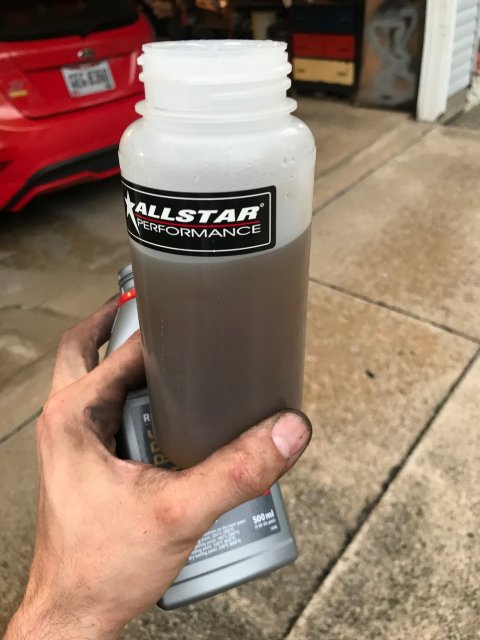

I baked my paint. Also my fluid.
How people don't have the same issues as me I'll never understand.

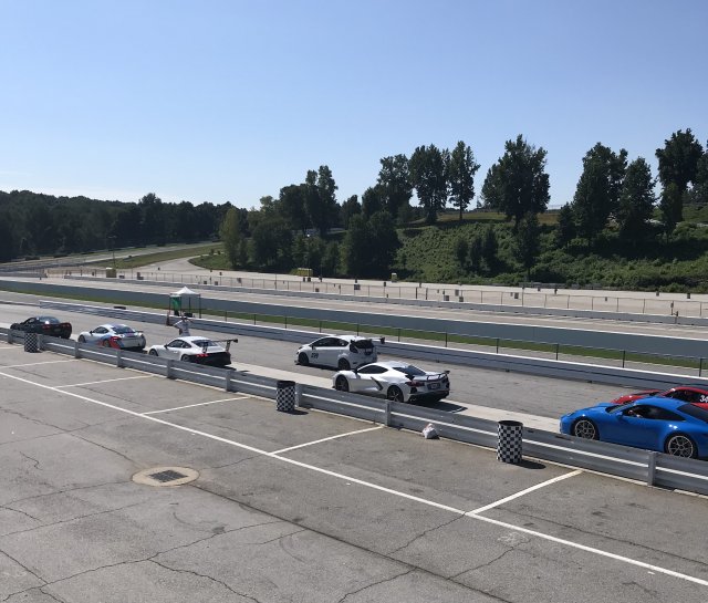

It's so cool to see a FiST in the group with all those cars that are probably worth 4x as much!
It’s always the odd car out. Always. Almost everyone I catch is respectful and usually lets me pass within a few turns. Most of those cars have significantly more top end so they have to let me stay ahead of them on the back straight for 1/2 lap.
A slightly larger turbo and more fuel would be better. I really dislike getting passed lol. Some would say I drive the wrong car. I disagree. My car’s power to weight is fantastic. I just need a little more power to push through the aero drag (mods for mods 😂).
And I could care less if it’s FWD or AWD or RWD. It’s about who’s driving the thing.
It’s taken me a lot of hours to figure out FWD. RWD is so much easier but this car always surprises me. I drifted out too far coming out of 10b at WOT, connected with the massive outside curbs and they through my car sideways just before the bridge while going whatever speed 3rd gear tops out at 😂. I just counter steered, stayed in it, didn’t die and had the hugest grin on my face for the next 20 minutes. The dude in the GT4 I passed going into 10a must’ve thought I was gonna die.
