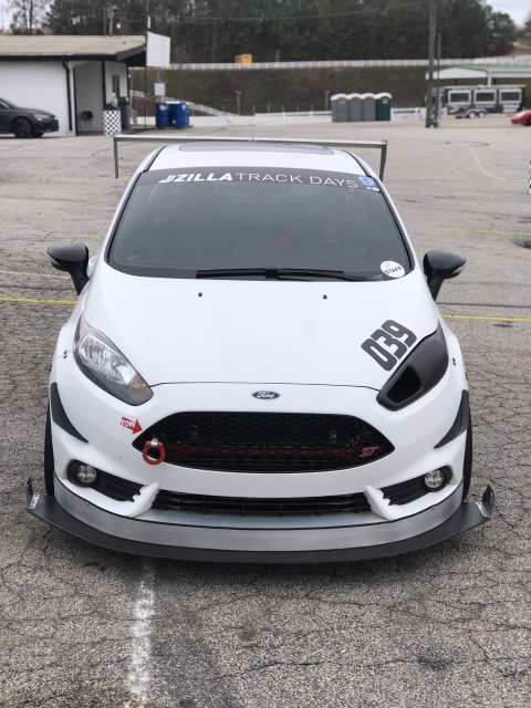

The car was absolutely rollin’ today even with boost limited to 25.4. Traction wasn’t the best with damp conditions so I ran my rain/cold weather map from Jared at Stratified. It’s still fast but I need to install the hood vents, have Johnny at NineLives rebuild my wing (it’s warped from where there was too much heat from welding a mount), build a functional diffuser and cut a couple of holes in the hatch to vent piled up air in the cabin. I’ll do all that and pull out more of the interior this winter so I can build a full cage. After the cage we will make more power.
