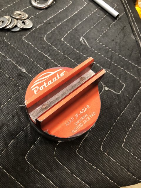

I made a custom pinch weld adapter that makes jacking up the car easy with the skirts installed. They still make it a pain in the ass though.

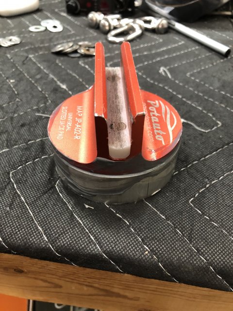

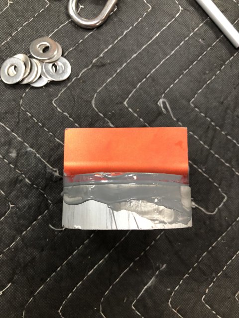

Any possibility of some details, pretty please? :)
I picked up an aluminum magnetic pinch weld adapter from Amazon and JB Welded it to a 1” piece of aluminum stock I had laying around. The diameter is the same so it worked out perfectly. Ugly but works. 58BA6020-45B8-4169-8344-417DF1480EA9.jpeg 3FB3E192-3E2B-4698-AA87-38420D72B61F.jpeg 6B034432-D2B5-4E5A-8291-0091AC11B619.jpeg

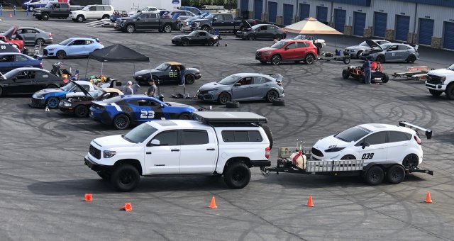

I dig the trailer, what kind is it?
Tennessee redneck model. He did a great job. I had to add brakes to both axles, a winch and a removable fender though. He used it to pull a buggy so it needed A LOT of tlc.. It pulls very easily and was super cheap aside from time I spent sanding and POR15ing everything.

I have something similar, works great. 👍
I actually tried a set of “permanent” Camaro pinch weld mounts first but sadly they didn’t work out. I typically lift the car really high and their gap was too tight to accommodate the angle before bending the pinch weld. That one looks perfect.
