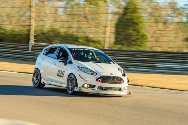

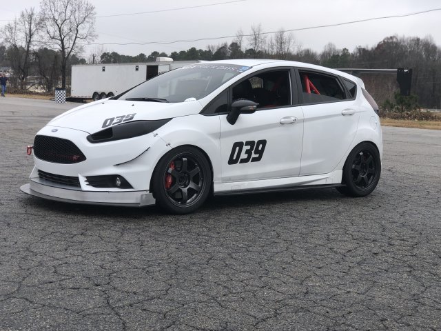

Can you tell us about your front splitter? Is it a full, functional belly pan?
It’s chassis mounted. There are pics somewhere in this thread of what my buddy built for me. I used 10mm Alumilite first but it’s too flimsy so I switched to 1/2” birch plywood and radius the lower portion of the leading edge. I use washers to adjust it from 0-1-2 degrees. I usually leave it at 1. No belly pan though. The splitter extends back to the traction bar. The spill boards are custom from Nine Lives Racing and the airdam was handmade from aluminum sheet.
