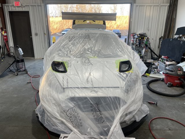

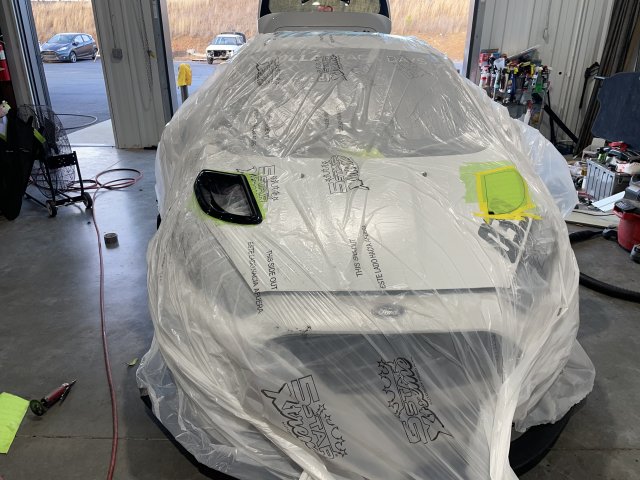

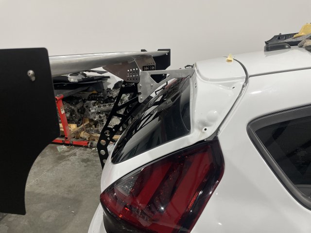

My OCD gets anxiety just looking at this picture hoping it'll be symmetrical if I was doing it
The picture isn’t showing it correctly but they’re damn perfect! I think the old hood number decal is throwing it off. I’m gonna leave that number like it is I think. 🤔

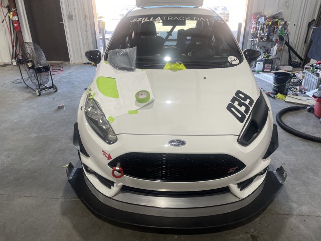

Wow, and I was worried that my Maxton V1 splitter was too big! :oops: By comparison to yours it's quite conservative.
Maxton parts are for aesthetics only. I’ve had three of their lips and the rear wing flap. They do nothing to stabilize the car but they looked cool. There’s old pics in the first few pages of my build.

Hope you didn't think I was being critical. I was just amazed at the size of it. I reckon it's one of the biggest splitters I've seen on the Fiesta ST. Try not to drive too close to the curb when driving it on the road, that's all, 'cause you don't want to start cutting peds off at the ankles!

Nah all’s good. Just wanted to make sure you weren’t expecting any functionality out of the Maxton stuff. All of mine ended up cracking. My splitter is actually made of birch plywood and chassis mounted. The endplates will cut shins that’s for sure. This is actually my smaller 3” version too. 😂

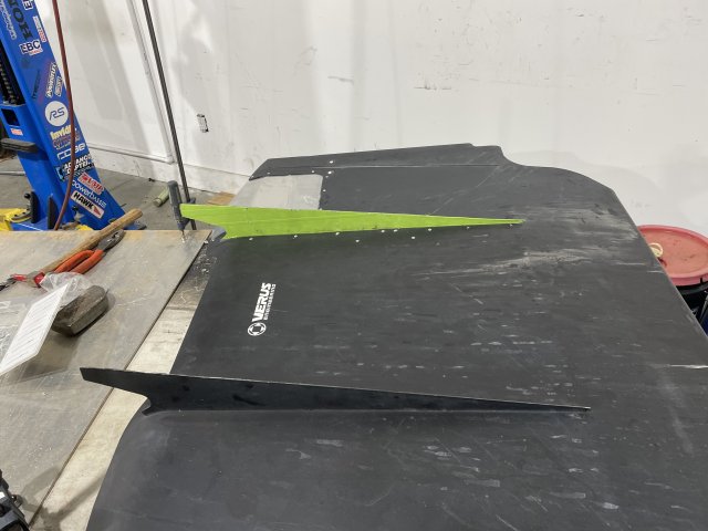

Yeah the wing will be notched on the bottom. Not sure how that’s happening yet. Likely just a couple of slits wide enough for it to flex a bit.

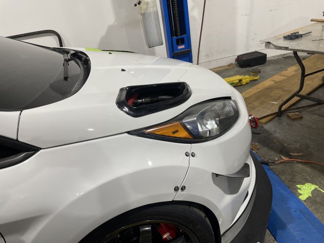

I cut out the inside of the fender to clear 235s. Those bolts attach the fender and bumper cover to a custom bracket.
Looks like you're going all out on building a full on race bruiser. Me? I'm just creating a pretty girl with an attitude. About the most extreme thing I intend to do is have the Revo Stage 4 330-350bhp done, but at the end of the day mine will always be for road use only.
