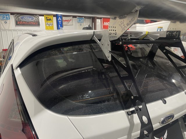

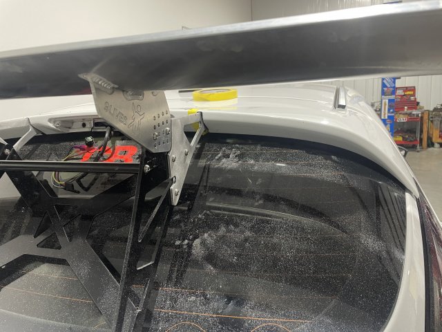

Here ya go buddy! F82FD32D-AA7E-4E33-A599-737664E25F51.jpeg B6D6A4DF-15A5-4E6F-A679-657D0561D6F4.jpeg

Looks great! Mine doesn't have that black bar/tube across the top so maybe we have different models.
He has so many different designs. 😂 I thought I was getting the one with the adjustable bar for fine tuning the angle. My big ass wing stays at zero.

I couldn't figure out why I had 4 of the little L brackets but seeing your pictures really helps. Thanks again.

One last favor - can you take pictures of the inside mounting points?
Unfortunately he didn’t grab any pics but he used two 1/4 20 rivnuts on each upper bracket. The bracket is solid and doesn’t move at all now.

Did you use rivnuts for the small L brackets that go into the wiper panel? Or is that a bolt/nut? If it's not covered up that's the part I was interested in seeing.

Oh. Yeah it’s just a bolt/nut with big washers on the inside. I used steel plates on the inside of the hatch for the bottom mounts. You’ll want to use a cutoff wheel and remove some of the inner sheet metal on the hatch to give you room to work and allow for larger plates. It definitely needs the upper brackets too in my opinion. After a few years the hatch fatigued at the lower mounts and it began to flex a lot more. All of that is gone now.
